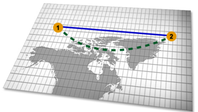

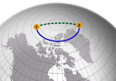

Cartesian vs. geodesic camera path
The logic of the camera path between keyframes, also known as a transition, is processed by a formula that controls the location and speed. The camera path can follow either a Cartesian or geodesic route. Cartesian is the transition path as if you were following a course over a flat, rectangular map. Geodesic is based on a spherical globe. All newly created keyframes are set to follow a Cartesian path type by default. If you have a keyframe camera path that does not follow the path you expect, you can change it in the Animation Properties pane. The effects of a geodesic or Cartesian route are most pronounced at the poles. For example, an aircraft would require a geodesic path to maintain a direct route as it passes over the north pole.
In the images below, you can compare how the generated paths will differ if you are working in a global view versus a map or local scene. The dashed line represents the geodesic path and the solid line represents the Cartesian path.
Cartesian versus geodesic in global view
Cartesian versus geodesic in a local scene and map view
