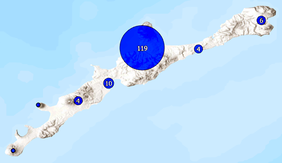

An example of one large cluster, a few small clusters, and two unclustered features on a map
In this feature clustering example, the largest cluster contains 119 features. Two features on the left remain unclustered.
