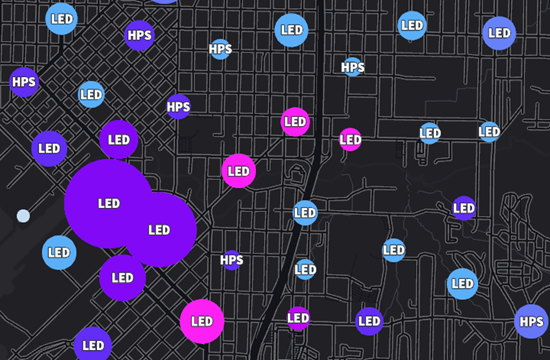

An example of a clustered feature layer displaying three variables
For example, this clustered feature layer displays three variables: the feature count (size), the maximum wattage (color), and the most common fixture type (text).

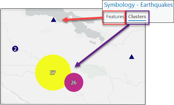

Clustered feature layers have two symbologies: one for feature, and one for clusters.
You control the symbology of clusters independently from the symbology of point features. When a feature layer has enabled clustering, the Contents pane shows both types of symbology in the layer's legend.
Clustered feature layer symbology
Clustered feature layers are symbolized in two ways. There is symbology for the clusters and symbology for the individual, unclustered features. Use the Clusters and Features tabs on the Symbology pane respectively to adjust the appearance of each.
