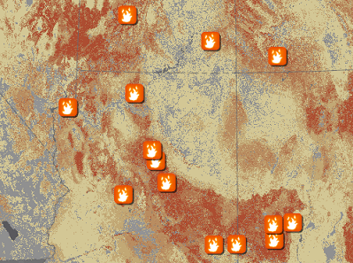

Single symbol symbology applies the same symbol to all features in a layer. This symbology is used for drawing a layer with only one category, such as county boundaries.
Map of the southwestern United States using single symbol symbology to represent locations of active fires
This wildfire potential map of the southwestern United States uses single symbol symbology to represent locations of active fires.
