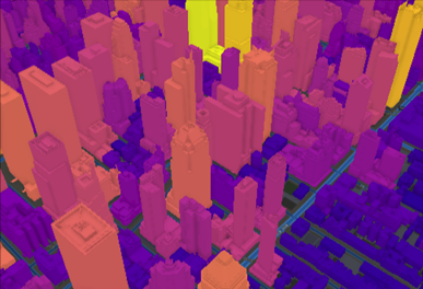

3D scene of New York City
This 3D scene of New York City uses a scientific color scheme as a visual variable to highlight taller buildings.
