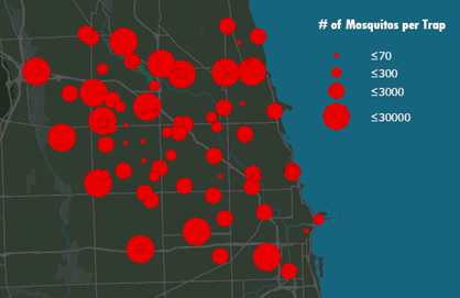

Map using graduated symbols
This map uses graduated symbols to show which mosquito trap locations in Chicago have the highest counts of mosquitos tested for West Nile virus.
Symbol size can represent differences in magnitude of a phenomenon, because larger symbols are naturally associated with a greater amount of something. Using graduated symbols allows you to control the size of each symbol, because they are not related directly to data values as they are with proportional symbols. This means you can design a set of symbols that have sufficient variation in the size that represents each class of data to make them distinguishable from one another.
