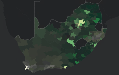

Map of South Africa that uses transparency as a visual variable
This map uses transparency as a visual variable against graduated colors symbology to emphasize more heavily populated districts.
