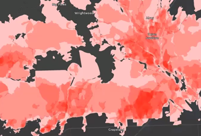

Apply feature blending
Feature blending is conceptually similar to layer blending, but instead the features blend with other features in the same layer. This is useful when many features overlap and you want to accentuate those features.
Fire perimeter polygon features with Multiply feature blending applied
Polygon features representing historical fire perimeters in southern California are feature blended using the Multiply mode to show event frequency.
