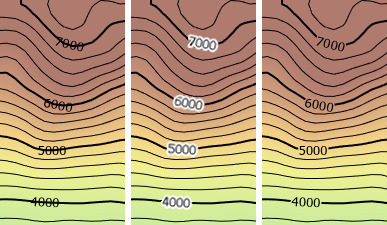

A common use for masking is to mask features around annotation to ensure the text remains readable. For example, in a hypsometric elevation map such as the one below, contour lines and text conflict. With masking, portions of the black contour lines are made invisible near the contour text to ensure it remains legible.
Three views of the same map area with black contour lines and annotation overtop a continuous gradient of hypsometric tinting
In the first image, the contour lines visually conflict with the annotation. In the second image, outline masks that were generated as a separate layer are added and drawn with a white polygon symbol. In the final image, the mask layer is used to mask the contour lines, and the visibility of the mask layer is off.
In this example, a polygon feature layer of small shapes that correspond with the placement of the annotation are used to mask the contour lines, visually breaking the line symbology. (The shapes, in white, were created by the Feature Outline Masks tool.) In the final image, the polygon mask feature layer is in the map but its visibility is off, so you don't see the mask polygons themselves.
If there was nothing else in the map other than the contour lines and the annotation, you could just add a white halo to the text symbol used for the annotation. But in a map such as this that has continuous hypsometric symbology below it, white halos would be unsuitable. Removing the visibility of pieces of the contour line symbols with masking is preferable.

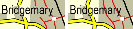

Advanced masking is layer masking, with the refinement where the masking effect can happen on only some symbol layers of the symbols of the selected layer. For example, you can mask just the black highway casing of road symbols where it conflicts with text, but allow the lighter yellow center of the road to remain underneath. This ensures visual continuity of the roads while improving the legibility of the text .
A comparison of a map with road symbols completely masked and road symbols with only casings masked
Layer masking, on the left, masks the entire road symbol. Advanced layer masking is used on the right to specify that only the black road casings are to be masked but the yellow and red symbol interiors are not masked.
