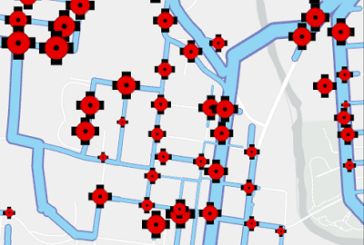

An example of single symbology varied by size
Fire hydrant and water main symbols are varied by size and width, respectively, to show hydrant flow rate and water main diameter.
