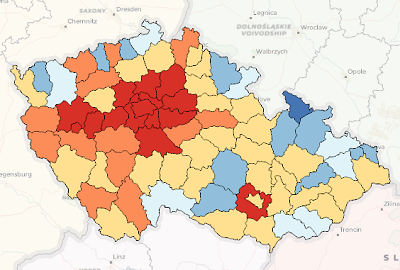

Graduated color symbology is used to show a quantitative difference between mapped features by varying the color of symbols. Data is classified into ranges that are each assigned a different color from a color scheme to represent the range. For instance, if your classification scheme has five classes, five different symbol colors are assigned. The size of the symbols stays the same. Maps that vary in color this way are usually called choropleth maps. Typically, you choose a continuous color scheme to apply different shades of the same color so that lighter shades match lower data values and darker shades match higher data values.
Example of graduated colors symbology
This choropleth map uses a diverging color scheme to show net migrant population growth or loss by district in the Czech Republic.
