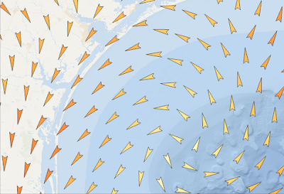

Wind speed and direction over the Gulf of Mexico near Corpus Christi, Texas
The grid-based symbols on this map use color to show wind speed and rotation as a secondary variable to indicate wind direction.
