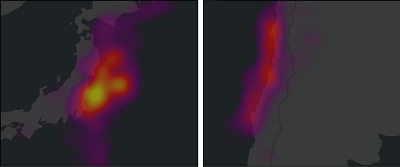

  • Constant method—The definition of density (how each color in the scheme relates to a density value) remains constant, regardless of map extent. Use the Constant method to make accurate comparisons across different areas in the map if the map scale remains the same. If the map scale changes, you can lock the radius to maintain the expected density. This method is the default and matches the method used by ArcGIS Online.
    With the Constant method, you can compare subsets of data. Use the time slider, range slider, definition queries, or selection layers to establish subsets for comparison.
    Comparison of two areas at the same scale using constant rendering
    Heat map symbology of earthquakes shown for two different areas, at the same scale, using the Constant method. The density definition is constant, so the areas can be compared.
    The density definition is determined by the range of data currently in view at the time the heat map symbology is applied. Click the Regenerate density button to regenerate the density definition based on the current view.

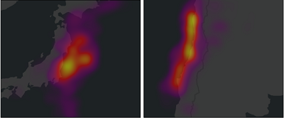

  • Dynamic method—The density definition (how each color in the scheme relates to a density value) is recalculated each time the map scale or map extent changes to reflect only those features that are currently in view. The Dynamic method is useful to view the distribution of data in a particular area but is not valid for comparing different areas across a map. The densest areas in the current view draw with the "hottest" colors, but these areas may not necessarily be the densest in the entire dataset. For example, if you map a city's crime hot spots, zooming out shows a bigger picture of criminal activity across the city, while zooming in shows more detailed density patterns in particular neighborhoods without having to reset symbology properties.
    Comparison of two areas at the same scale using dynamic rendering
    Heat map symbology of earthquakes shown for two different areas, at the same scale, using the Dynamic method. The density definition is recalculated for each extent, so the local variations are shown using the full color scheme.
