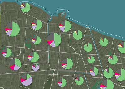

Census tract map using pie chart symbology
Census tracts in New Orleans use pie chart symbols to show ethnicity percentage. The symbols are sized by total population.
