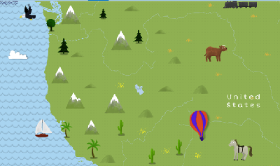

Children's Map
A portion of Esri's A Children's Map.
This map does not have a layer for streets in its style. By editing a copy of the vector tile style for it, the "streets" tile source can be added to the sources property. Then new layers can be added to the style that reference the new "streets" source.

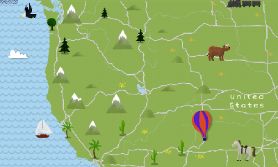

Children's Map with streets
A portion of Esri's A Children's Map combined with the Streets tile source.
