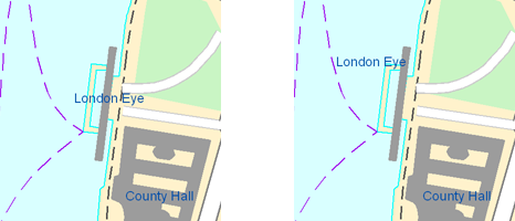

The images below show the London Eye Ferris wheel labeled with the Overrun parameter set. In the image to the left, a Maximum overrun distance is specified and the label is placed near the center of the polygon and evenly over the polygon boundary. The image to the right shows the Allow asymmetric overrun option being used. The buildings, land use, and street features have had feature weights set, so the label is placed over the water, which has no weight.
