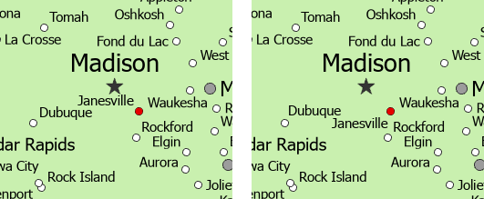

The images below show the city labels with changes to the ambiguity settings. The image on the left shows ambiguous labels being removed for the small city label class using the Remove within same label class option. Janesville is the red point feature. To make the label unambiguous for the label class, it is moved to the upper left of the feature. Because the Maplex Label Engine is only removing ambiguous labels within the label class, the label is placed close to the Madison point feature, as it is in a different label class. The image on the right uses the Remove all option for removing ambiguous labels. The Janesville label moves to the lower left of the point feature so it does not fall within the offset distance of the Madison point feature.
Two labeled maps comparing the placement of a label in an ambiguous position and in a clearer position

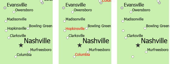

The images below show the city labels placed to the upper right of their features using the Top right of point placement position. The image on the left shows how labels are placed when the Remove ambiguous labels option is set to Do not remove. The images in the center and on the right show how the ambiguous labels are removed when the Remove ambiguous labels option is set to Remove all. The Hopkinsville and Columbia labels are removed, as they are within the offset distance of the Bowling Green and Murfreesboro features. The red labels in the center image are the unplaced labels, shown by clicking the View Unplaced button on the Labeling ribbon.
Three labeled maps comparing options for ambiguous labels
