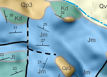

Repeat labels within a polygon feature
When placing labels using the Regular placement style and the interior label position options, you can use the Repeat option to place the label throughout the feature. The labels will be placed in the outlying fingers of the polygon feature and in a grid pattern through the body of the feature. The distance between the labels is determined by the Minimum interval value.
The image below shows the polygon labels from the Upper Jurassic Morrison Formation (Jm) repeating through the geologic feature.
Polygon label repeating within a polygon feature
