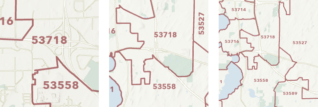

In the example below, the scale stops are set at 1:250,000 with a 9 point font and 1:24,000 with a 28 point font. The image on the left shows the map drawn at a scale of 1:45,000 with the label drawn in a larger font. The middle image shows the map drawn at 1:125,000, and the image on the right shows it at 1:245,000. As the map is zoomed out, the font size decreases according to the scale stop settings.
Three labeled maps show the label size changing at different scales.
