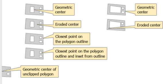

When labeling polygon features using a text symbol with a callout, you can use the Maplex Label Engine to set the anchor point for the callout symbol. The anchor point location options where the callout snaps to the feature are as follows:
  • Geometric center
    If the anchor point is unable to be placed at the geometric center of the polygon, it is placed on the closest point on the outline to the label. The geometric center of the polygon is the center of gravity for the polygon. This center does not always fall within the feature; when it doesn't, the anchor point is placed on the feature outline. This is the default.
  • Eroded center
    The anchor point is placed at the eroded center of the polygon. The eroded center is determined by stripping away the outer layers of the polygon (like peeling an onion) until there is one center point left. This eroded center always falls within the polygon boundary.
  • Closest point on the polygon outline
    The anchor point is placed at the closest point on the polygon outline to the label or inset from the polygon outline by a defined amount when using the Inset from outline option. This option is useful when labeling boundaries between polygons, and labeling the boundary wouldn't be clear as to which polygon was being labeled.
  • Geometric center of unclipped polygon
    The anchor point is placed at the geometric center of the unclipped polygon. If the polygon falls partly outside the current extent, the Maplex Label Engine uses the entire polygon to calculate the geometric center. If the anchor point cannot be placed at the geometric center due to a hole in the feature, the eroded center of the clipped polygon is used. Because the Maplex Label Engine is using the unclipped polygon to place the anchor point, it may be placed outside the current extent.
The following image shows these callout anchor location options:
Available callout anchor locations
Available callout anchor locations are shown.
