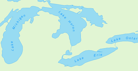

The following image shows the Great Lakes labeled with the River placement style and the Word spacing parameter:
Word spacing parameter used with the River placement style.
