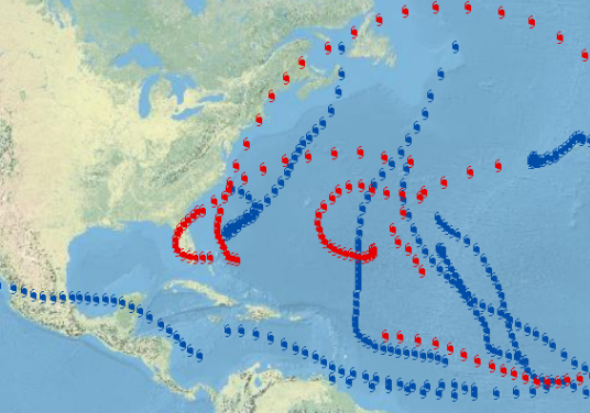

Imagine you have data from two different time periods that you want to compare side by side. It may be useful to play back the two sets of data as if they were happening at the same time. This allows you to look for similar patterns or differences in the datasets. For example, you can compare the hurricane seasons for two consecutive years by applying a temporal offset of exactly one year to the data from the first season. Then you can play back the two hurricane seasons together as if they were happening in the same year. This allows you to look for patterns of when and where hurricanes are occurring between the two years. This example is illustrated below:
Time offset on a map
