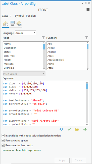

The appearance and content of the sign labels are determined by the label expressions that are used to process the AirportSign layer field values with font and color information. These Arcade expressions are provided in the ArcGIS Aviation Airports product files installer. You don't always need to modify these expressions, but they can be customized.
Modify layer expressions
The Arcade expression files provided in the ArcGIS Aviation Airports product data package provide a customizable label display for your airport signs.
You can find Arcade expressions for both the front and back labels of your airport signs in the \Arcade Expressions\Layers directory within the ArcGIS Aviation Airports product data package. These are already incorporated into the AirportSign_frontBack_layer.lyrx layer file. You can edit these expressions to fit your needs.
Note:
You should only edit the layer expressions in the expression editor in the Label Class pane.
The Label Class properties for the AirportSign layer
Learn more about writing Arcade expressions

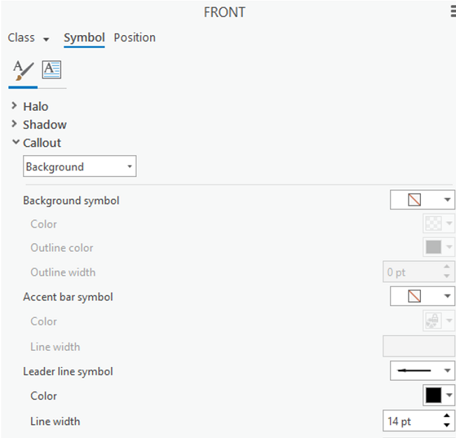

You can use a smaller scale and use leader lines to point to a sign location with the labels placed for a best fit.You can edit the Offset X value—for example, 150 pt for the FRONT class and -150 pt for the BACK class—and add the leader line symbol. This allows you to display larger signs at a smaller map scale without obscuring the sign's exact location on the map. Once these labels are converted to feature-linked annotation, they can be edited for more precise placement.
Adjacent airport sign labels with leader line
A leader line symbol can be added to either the FRONT or BACK class, but only one class is needed.
  1. On the Symbol tab, ensure that Background is chosen in the Callout drop-down menu.
    Symbol tab of the FRONT class for airport signs
  2. Click the Leader line symbol drop-down arrow and choose a leader line symbol image.
  3. Click Apply.
