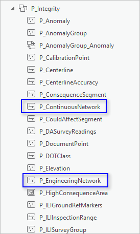

The following image shows the ArcGIS Pro Catalog pane view of P_ContinuousNetwork, a derived network in the LRS, and P_EngineeringNetwork, a line network in the LRS:
Line and derived networks in the LRS
