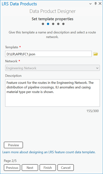

To set the template properties once the template type is specified, complete the following steps:
  1. Provide a template name.
    By default, the template is saved in the project folder. Optionally, browse to a different location, provide a name for the template, and click OK.
  2. Click the Network drop-down arrow and choose a network.
    Route characteristics will be provided for this network when the Generate LRS Data Product tool is run with the template.
  3. Optionally, provide a description.
    Template properties are set on the Set template properties page.

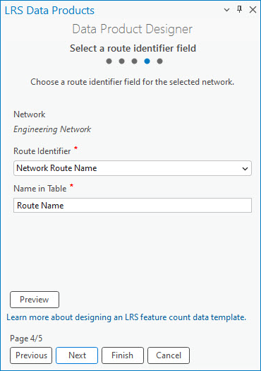

The next step to produce a template for an LRS feature count data product is to add a route identifier field. The route identifier can be a route name or a route ID.
This example uses Route Name as the network's route identifier field.
To specify a route identifier field, complete the following steps:
  1. Click the Route Identifier drop-down arrow and choose a field.
    The default option is Route ID if the specified network is a non-line network, or Route Name if the specified network is a line network.
    If the specified network has both a route ID and a route name configured, you can choose one of the two options using the drop-down arrow.
    Choose a route identifier field for the selected network.
  2. Optionally, update the display name in the Name in Table text box.
    The default display name is the Route Identifier value.
    Choosing a route identifier field ensures that the route log data product generated using this template will include route information fields.

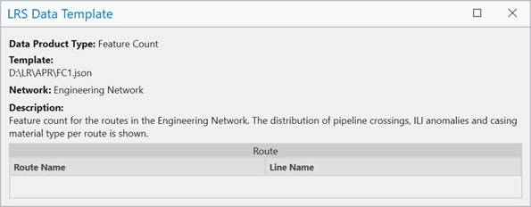

  3. Optionally, click Preview to preview the route identifier field on a canvas.
    The canvas after adding a route identifier field

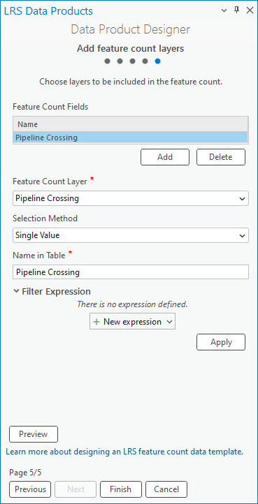

    The first feature count layer configured in the example is the Pipeline Crossing point event layer.
  3. Click the Selection Method drop-down arrow and choose a selection method:
    • Single Value—Add a single feature count field.
    • Unique Values—Add multiple unique values for a feature count layer. Each unique value becomes an individual field. This option is only available when a feature count layer is provided without a name or filter.
    For this example, Single Value is used to configure the Pipeline Crossing layer.
    Add a feature count layer to be included in the feature count data product.
  4. Provide a display name in the Name in Table text box.
    The text provided here populates the blank row in the Feature Count Fields table.

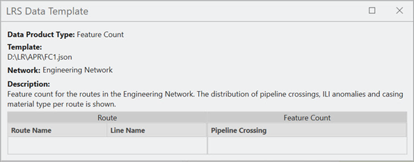

    The canvas after adding a feature count field
    You can preview the template after adding the Pipeline Crossing feature count field.

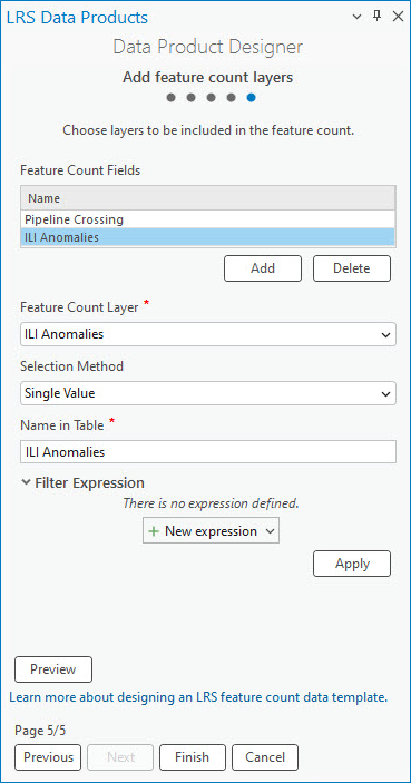

    The second feature count layer configured in the example is the ILI Anomalies point event layer.
    Add a second feature count layer to be included in the feature count data product

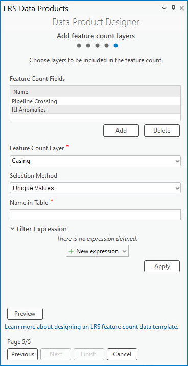

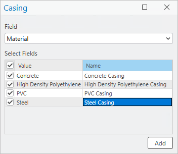

    The next four feature count fields in the example are Concrete, Steel, PVC, and High Density Polyethylene. All four casing material types belong to the Casing line event layer. The following steps demonstrate how to add these fields using the Unique Values selection method.
  7. Repeat step 1 above.
  8. Click the Feature Count Layer drop-down arrow and choose a feature count layer.
    For this example, the Casing layer is chosen as the feature count layer.
  9. Click the Selection Method drop-down arrow and choose Unique Values.
    Add a feature count field using the Unique Values selection method.
    A pop-up appears.
  10. Click the Field drop-down arrow in the pop-up, to choose a field and do the following:
    1. Check the check box next to each field to choose the unique values.
    2. Optionally, update the name of each selected field in the Name column.
      The name becomes the name of the feature count field when the unique values are added to the Feature Count Fields table.
    3. Click Add to add the selected unique values as feature count fields.
      Each feature count field automatically has Single Value as the selection method, as well as a filter expression that corresponds to the unique values.
      Selected fields when using the Unique Values selection method

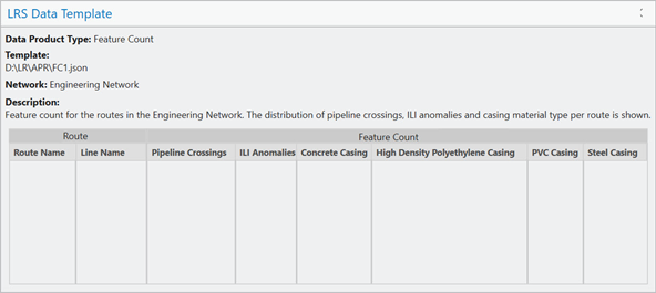

  11. Click Preview to verify the fields on the canvas.
    The canvas after adding all the fields
