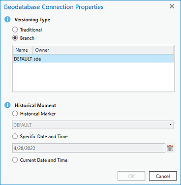

  2. Once the LRS is created, calibrated, and configured in the file geodatabase, prepare the target multiuser geodatabase for the LRS, feature classes, and tables you want to migrate, and set the connection file versioning type to branch.
    Note:
    Ensure that the connection file Versioning Type is set to Branch.
    Learn more about using the Geodatabase Connection Properties dialog box

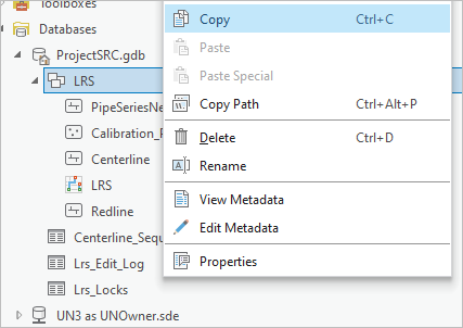

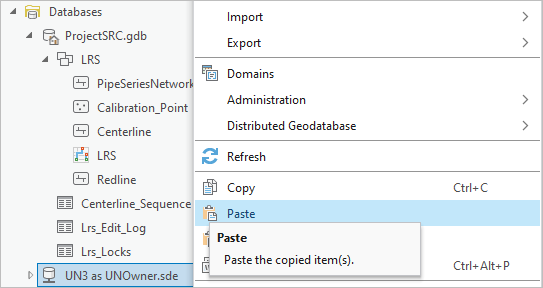

  3. In the Catalog pane, copy the LRS feature dataset that contains all the feature classes from the source geodatabase into the root level of the target geodatabase.
    Copy the LRS feature dataset
    Paste the LRS feature dataset into the target geodatabase
