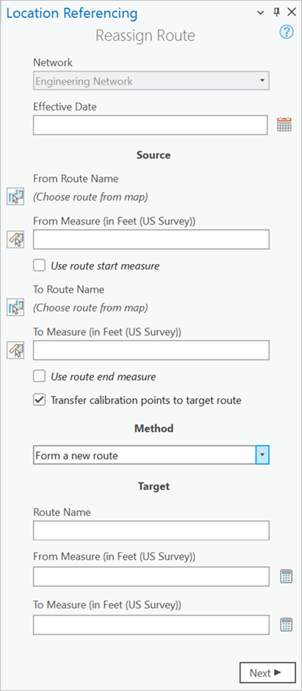

  3. On the Location Referencing tab, in the Routes group, click Reassign .
    The Reassign Route pane appears.
  4. Click the Network drop-down arrow and choose the network in which the route reassignment will take place.
    Note:
    To edit using feature services, the LRS Network must be published with the Linear Referencing and Version Management capabilities.
  5. Click the Effective Date drop-down arrow, and choose a date for the edit.
    Tip:
    You can also provide the date, or double-click the empty Effective Date text box to insert the current date.
  6. In the Source section, click the Choose route from map button and click the route on the map to populate From Route Name.
    Note:
    After clicking the Choose route from map button or the Choose measure from map button , you can hover over the routes to see the route and measure at the location of the pointer.
    If only one applicable route exists at the edit location, click to select it. If multiple routes are applicable, click to select one of the applicable routes using the Select Route dialog box.
    You can set map scale options for display of route and measure information on the Options dialog box, on the Location Referencing tab.
  7. Provide a starting measure value for the route by doing one of the following:
    • Provide a value in the From Measure text box.
    • Click the Choose measure from map button and click a measure on the map.
    • Check the Use route start measure check box.
    A green dot is placed at the location. The reassignment starts from this location.
  8. Click the Choose route from map button and click the route on the map to populate To Route Name.
  9. Provide an ending measure value by doing one of the following:
    • Provide an ending measure value in the To Measure text box.
    • Click the Choose measure from map button , and click a measure on the map.
    • Check the Use route end measure check box.
    A red dot is placed at the location. The reassignment takes place on the routes or the portions of routes that exist between the green and red dots. The routes that are intersected by the reassignment portion are retired.
  10. Choose whether to recalibrate the remainder of the reassigned route downstream of the reassigned portion.
    • Check the Recalibrate route downstream check box to recalibrate the remainder of the reassigned route downstream of the reassigned portion.
    • Uncheck the Recalibrate route downstream check box if you do not want to recalibrate the remainder of the reassigned route downstream of the reassigned portion.
  11. Choose whether to transfer the source calibration points to the target route using the Transfer calibration points to the target route check box.
    The Transfer calibration points to the target route check box is checked by default and is the preferred method to maintain established measures between points.
    Note:
    All of the calibration points between and including the starting measure and ending measure values, even those spanning routes in between, are included in the transfer of calibration points to the target route.
    The Reassign Route pane is populated.
  12. Choose the Form a new route method for reassignment:
    Form a new route selection
  13. In the Target section, in the Route Name text box, provide a new route name to reassign to a new route.
  14. Provide a starting measure value for the target route reassignment location by doing one of the following:
    • Provide a starting measure value in the From Measure text box.
    • Click the Recalculate From Measure button . The starting measure value is calculated as the source measure length minus the ending measure value.
    Note:
    • If you are adding the reassigned route to the end of the target route, this value is equal to the end measure of the target route.
    • For the line network, the measures can be entered as station values in 00+00.00 or 00+00.000 format.
  15. Provide the ending measure value of the target route reassignment location by doing one of the following:
    • Click the Recalculate To Measure button . The ending measure value is calculated as the source measure length minus the starting measure value.
  16. Click Next.
