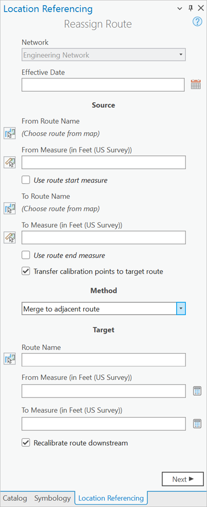

  3. On the Location Referencing tab, in the Routes group, click Reassign .
    The Reassign Route pane appears.
  4. Click the Network drop-down arrow and choose the network in which the route reassignment will take place.

    The Reassign Route pane is populated.
  12. Choose the Merge to adjacent route method for reassignment:
    Reassign Route pane with Merge to adjacent route specified
    Merge to an adjacent route.
