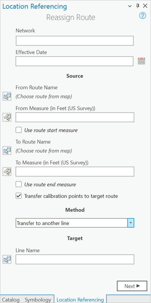

  12. Choose Transfer to another line as the method for reassignment:
    Reassign Route pane with Transfer to another line method specified
  13. In the Target section, click the Choose line from map button and select the target line on the map.
    The name of the line you selected on the map populates the Line Name text box and the source routes will be transferred to this line.
    Note:
    Alternatively, provide a new name. If the provided name doesn't exist in the database, a new line is created, and the source routes will be transferred to this new line.
