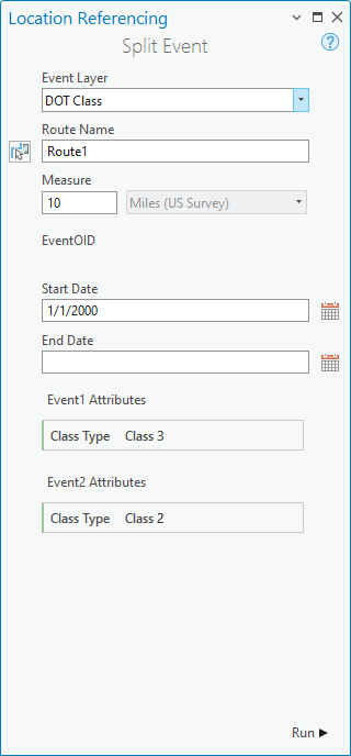

  2. On the Location Referencing tab, in the Events group, click Split .
    The Split Event pane appears.
    Split Event pane
  3. From the Event Layer drop-down list, choose the event layer that contains the event you want to split.
    All of the line event layers in the feature service appear in the Event Layer drop-down list. The Event1 Attributes and Event2 Attributes options and values update when the event layer changes.
  4. Choose a route by clicking the Choose route from map button , and on the map, click the measure on the route where you want to split the line event.
    The Route Name and Measure options are populated in the Split Event pane.
    The event is split into two events on either side of the point. Alternatively, you can provide a measure value in the text box.
    The event object ID of the selected event appears in the EventOID area.
    Note:
    After clicking the Choose route from map button , you can hover over the routes to see the route and measure at the location of the pointer.
    You can set map scale options for display of route and measure information on the Options dialog box, on the Location Referencing tab.
    Note:
    If a message regarding acquiring locks or reconciling appears, conflict prevention is enabled.
  5. Click the Start Date and End Date calendars, and choose the start and end dates of the event being split.
    The event start date default value is the current date and the end date default value is null.
  6. Edit the Event1 Attributes and Event2 Attributes values as needed.
  7. Click Run to split the event record into two events using the provided values.
    A confirmation message appears once the split events are saved.
