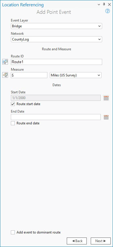

    Add Point Event pane
    Using the Route and Measure method, the measure location is based on the measure values from the selected route.
  3. Click Next.
    The Route and Measure and Dates sections appear in the Add Point Event pane.
  4. Click the Event Layer drop-down arrow and choose the point event layer where you want to add the event.
    The selected Network value is based on the selected event layer.
  5. Specify a route by doing one of the following:
    • Provide a route ID in the Route ID text box.
    • Click Choose route from map , and click on the route where you want to add the point event.
    The measure is initially populated using the route location where you clicked.

  6. Specify a new location by doing one of the following:
    • Provide the value in the Measure text box.
    • Click Choose measure from map , and click the measure value along the route on the map.
    Once the measure is provided, a green dot appears on the map at that measure location.
  7. The start date default value is the current date, but you can change the date by doing one of the following:
    • Provide the start date in the Start Date text box.
    • Click Calendar and choose the start date.
    • Check the Route start date check box.
  8. Optionally, specify the end date for the point event by doing one of the following:
    • Provide the end date in the End Date text box.
    • Click Calendar , and choose the end date.
    • Check the Route end date check box.
    If no end date is provided, the event remains valid from the event start date into the future.
