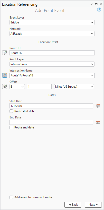

  3. Click the Method drop-down arrow and choose Location Offset.
    Add Point Event pane with Location Offset method
  4. Click Next.
    The Event Layer drop-down menu, the Network drop-down menu, the Location Offset section, and the Dates section appear in the pane.
  5. Click the Event Layer drop-down arrow and choose the event layer where the event will be created.
    The Network value is populated based on the Event Layer value.
  6. Specify the route ID by doing one of the following:
    • Provide the route ID in the Route ID text box.
    • Click Choose route from map and click a route on the map.
  7. Click the Point Layer drop-down arrow and choose the intersection, LRS point event, or non-LRS point layer name.
    Note:
    All the point layers that are published with the feature service are listed. LRS point events from a network other than the one specified under Network are not listed. The LRS calibration point layer is not supported.
  8. For the text box below the Point Layer drop-down menu, specify the point feature’s name by doing one of the following:
    • Provide the name of the point feature in the text box.
    • Click Choose location from map and click a point feature on the map to populate the text box.
    Note:
    • The name of the text box below the Point Layer drop-down menu is dependent on the point layer's display field. If a custom display field is set or the display field set does not have a value, the feature cannot be selected.
    • If more than one point feature exists at the clicked location, the Select Feature dialog box appears.
  9. Provide the Offset value for the location by doing one of the following:
    • Click the Offset drop-down arrow and choose the offset direction, provide a measure value, and choose the units.
    • Provide the measure value and choose the units.
    • Click Choose offset from map and click a location along the route on the map.
    A green dot appears at the offset location along the route on the map. This is the location of the measure value for the event.
    Note:
    • The offset value is the distance between the chosen point layer and the proposed measure on the selected route.
    • The direction is an optional selection.
    • If no direction is selected, a positive offset value places the measure location along the direction of calibration from the selected point feature.
    • If no direction is selected, a negative offset value places the measure location opposite the direction of calibration from the selected point feature.
  10. Specify the date that defines the start date of the event by doing one of the following:
    • Provide the start date in the Start Date text box.
    • Click Calendar and choose the start date.
    • Check the Route start date check box to use the route start date.
    The start date default value is the current date, but you can specify a different date.
  11. Specify the date that defines the end date of the event by doing one of the following:
    • Provide the end date in the End Date text box.
    • Click Calendar and choose the end date.
    • Check the Route end date check box.
    The end date is optional. If no end date is provided, the events remain valid from the event start date and into the future.
  12. Click Next.
    Attributes for the chosen event layer appear under Manage Attributes.
  13. Provide attribute information for the event.
    Manage Attributes section
    Note:
    Click Copy attribute values by selecting event on the map and click an existing point event belonging to the same event layer on the map to copy event attributes from that event.
  14. Click Run.
    A confirmation message appears once the newly added point event is created. The new point is created and appears on the map.

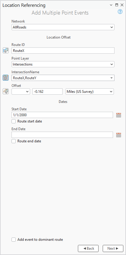

    Add Multiple Point Events pane with Location Offset method
  4. Click Next.
    The Network drop-down menu, the Location Offset section, and the Dates section appear in the pane.
  5. Click the Network drop-down arrow and choose an LRS Network.
  7. Click the Point Layer drop-down arrow and choose the intersection, LRS point event, or non-LRS point event layer name.
    Note:
    All the point layers that are published with feature service are listed. LRS point events from a network other than the one specified under Network will not be listed. The LRS calibration point layer is not supported.
  8. For the text box below the Point Layer drop-down menu specify the point feature's name by doing one of the following:
    Note:
    • The name of the text box below the Point Layer drop-down menu is based on the point layer's display field. If a custom display field is set or the set display field does not have a value, the feature cannot be selected.
  9. Specify the Offset direction for the location by doing one of the following:
    • Click the Offset drop-down arrow and choose the offset direction, provide the measure value, and choose the units.
    Note:
  10. Specify the date that defines the start date of the events by doing one of the following:
    Note:
    The start date cannot be before the start date of the selected route.
    The start date default value is today's date, but you can specify a different date.
  12. Click Next.
    Manage Attributes appears.
    The Attribute Set drop-down menu includes other attribute sets if configured for the LRS Network.
  13. Optionally, choose an attribute from the Attribute Set drop-down menu.
    Note:
    You can uncheck the check box next to individual event layers to exclude them from event creation.
  14. Provide attribute information for the event layer.
    Add Multiple Point Events pane with Manage Attributes section
    Note:
  15. Click Run.
    A confirmation message appears once the newly added point events are created. The new point events are created and appear on the map.
