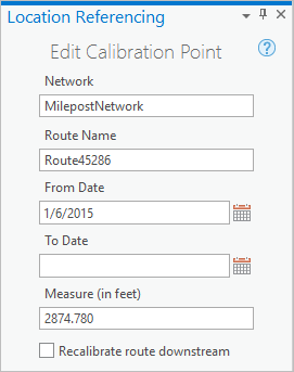

  4. Select an existing calibration point on the map.
    The Edit Calibration Point pane appears with attributes for the selected calibration point populated.
  5. Change the From Date and To Date values when this calibration is applied to the route.
  6. Change the measure value of this calibration point.
  7. Optionally, check the Recalibrate route downstream check box to recalibrate the route downstream.
    When this check box is checked, recalibration is applied to downstream calibration points along the route.
    For example, if an existing calibration (or measure) at the location where you want to edit a calibration point is 5, and the next downstream calibration point at the end of the route has a measure of 10, changing a measure of 5 to 6 with the Recalibrate route downstream check box checked results in a downstream calibration point with a measure of 11.
    When this check box is unchecked, no recalibration is applied to the downstream calibration points along the route.
    For example, if an existing calibration (or measure) at the location is changed from 5 to 6, leaving the Recalibrate route downstream check box unchecked results in the downstream calibration point maintaining a measure of 10.
  8. Click Run.
    Calibration on the route is updated.
