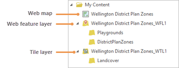

    The web map and new web layers that will be created are displayed in the pane.
    List of web map and new web layers
    In this example, a web feature layer and a tile layer are created in addition to the web map. The web feature layer contains sublayers.
