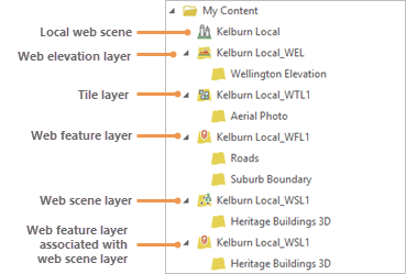

    The web scene and new web layers that will be created are displayed in the pane.
    List of web scene and new web layers
    In this example, several web layers are created: a web elevation layer, a tile layer, a web feature layer with sublayers, a web scene layer, and a web feature layer that is associated with the web scene layer.
