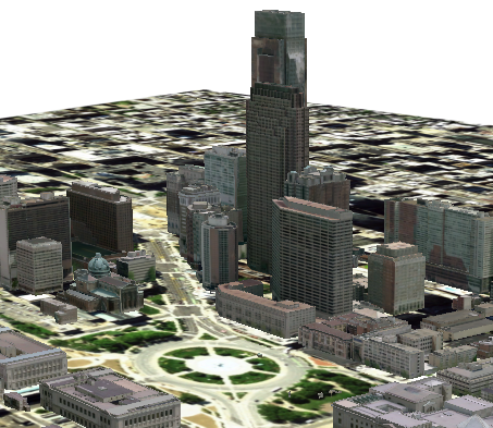

    For scenes that are ready to run through the Create Mobile Scene Package tool, use WebMercator_PostProcess or WGS84_PostProcess. Choose Option 1 or Option 2 below, depending on whether the mobile scene package is intended for a local scene in the Web Mercator Auxiliary Sphere coordinate system or a global scene in the WGS84 coordinate system. If this project is for an app that was built with the ArcGIS Maps SDKs, follow Option 2, because they only support global scenes. Alternatively, Option 1 can be followed as long as the scene is converted to a global scene and a basemap is used. If you have access to a portal, the quickest way to create tile packages is to use Option 3.
    Downtown Philadelphia
