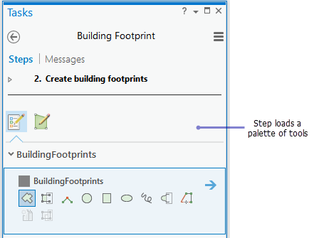

In the graphic below, the palette loads both the Create Features pane and the Move tool for the task step. The palette will allow the task user to create and move a building polygon in the same step.
Palette
A palette that loads the Create Features pane and the Move tool.
