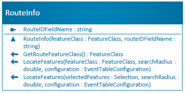

The RouteInfo class represents information about a route feature class, such as RouteIDFieldName (a unique route identifier) and the underlying route feature class, which can be accessed from RouteInfo.GetRouteFeatureClass(), as follows:
using (FeatureClass routesFeatureClass = geodatabase.OpenDataset<FeatureClass>("Roads"))
    RouteInfo routeInfo = new RouteInfo(routesFeatureClass, "RID");

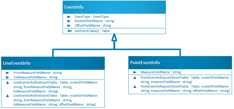

The EventInfo class represents information about the event table. The PointEventInfo class describes a measure, offset, and unique route identifier fields. Similarly, the LineEventInfo class holds information about the beginning and end of events in addition to the offset and unique route identifier fields.
using (Table eventsTable = geodatabase.OpenDataset<Table>("Accidents"))
    EventInfo eventInfo = new LineEventInfo(eventsTable, "RID", "fromMeasure", "toMeasure");

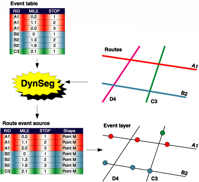

Dynamic Segmentation
Dynamic segmentation is the process of computing the shape (map location) of events stored in an event table along linear features.
Linear features such as highways, railroads, rivers, and pipelines typically have only one set of attributes, but dynamic segmentation provides an intuitive way for multiple attributes to be independently associated with any portion of an existing linear feature. These attributes can be displayed, queried, edited, and analyzed without affecting the underlying linear feature's geometry.
For example, users often have to document various characteristics of roads. Without using linear referencing, this could result in roads being divided into multiple small segments at each point where attribute values like number of lanes, road material, speed, and condition change. Dynamic segmentation enables these scenarios to be handled as linear referencing events along the roads, as illustrated in the figure below:
The result of the dynamic segmentation process is a dynamic feature class between routes and route events, known as the route event source.

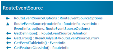

The RouteEventSource constructor takes RouteInfo, EventInfo, and RouteEventSourceOptions as parameters to create a dynamic feature class, i.e., RouteEventSource.

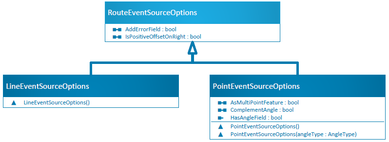

RouteEventSourceOptions defines the configuration used to create a RouteEventSource. Advanced dynamic segmentation options such as event locating angles, point events as multipoint features, offset direction, and event locating errors are also available depending on whether you are visualizing point events or line events.
PointEventRouteSourceOptions defines the configuration used to create a RouteEventSource from point events. If an angle type is provided in the PointEventRouteSourceOptions constructor, the LOC_ANGLE column will be added to the RouteEventSource to display the angle of the route where the event is placed.
// The dynamic segmentation process calculates the normal (perpendicular) angle of the route where the event is placed.
RouteEventSourceOptions pointEventSourceOptions = new PointEventSourceOptions(AngleType.Normal)
    // Calculates the complement of the normal angle.
    ComplementAngle = true,
    AddErrorField = true
If the AddErrorField property is true, the LOC_ERROR column will be added to the RouteEventSource to indicate locating errors encountered during RouteEventSource creation. These errors can also be accessed from RouteEventSource.GetErrors().

        RouteEventSourceOptions routeEventSourceOptions =
                         new LineEventSourceOptions() { IsPositiveOffsetOnRight = true };
        using (RouteEventSource routeEventSource =
                     new RouteEventSource(routeInfo, eventInfo, routeEventSourceOptions))
        using (RouteEventSourceDefinition routeEventSourceDefinition = routeEventSource.GetDefinition())
            // Locating errors
            IReadOnlyList<RouteEventSourceError> errors = routeEventSource.GetErrors();
            // Route event source fields
            IReadOnlyList<Field> routeEventSourceFields = routeEventSourceDefinition.GetFields();

The RouteInfo.LocateFeatures method computes the intersection of input features and routes and writes the route and measure information to a new event table defined by EventTableConfiguration. Feature selection can be used to reduce the number of input features.

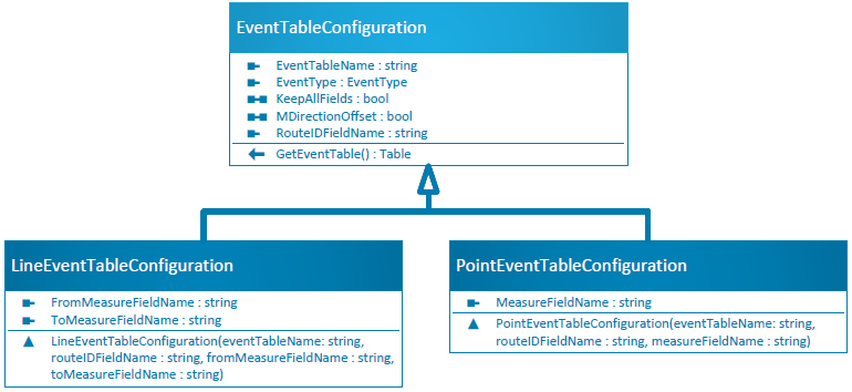

The PointEventTableConfiguration describes the configuration for creating an event table to store point events, and the LineEventTableConfiguration defines the configuration for storing line events.
When locating point features along routes, each point feature's route and measure information is computed and written to a point event table.
Similarly, when locating line or polygon features along routes, the feature's start and end measure information is calculated at the intersections between the line or polygon features and the route data and written to a line event table.
