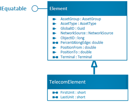

Telecom Element
The TelecomElement class represents a row in a utility network associated with a telecom domain network, and it inherits from the Element class. TelecomElement includes FirstUnit and LastUnit properties that enable logical grouping of rows with shared attributes and topology by using a single record for non-spatial objects such as rows, edge objects, junction objects, and associations.
A telecom element can be created from an asset type and a global ID by using the utilityNetwork.CreateElement() method, as shown below:
TelecomElement element = utilityNetwork.CreateElement(assetType, new Guid(globalID)) as TelecomElement;

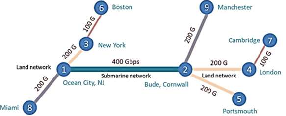

Telecom companies use multiple circuits to create a service delivery path between two network elements. This set of components forms a signal path that connects specific start and stop points within the network. Telecom circuits can be defined either directly on the physical network infrastructure as physical circuits or logically on top of the physical network infrastructure as virtual circuits. Virtual circuits are often established between start and stop locations when the underlying physical network is unknown.

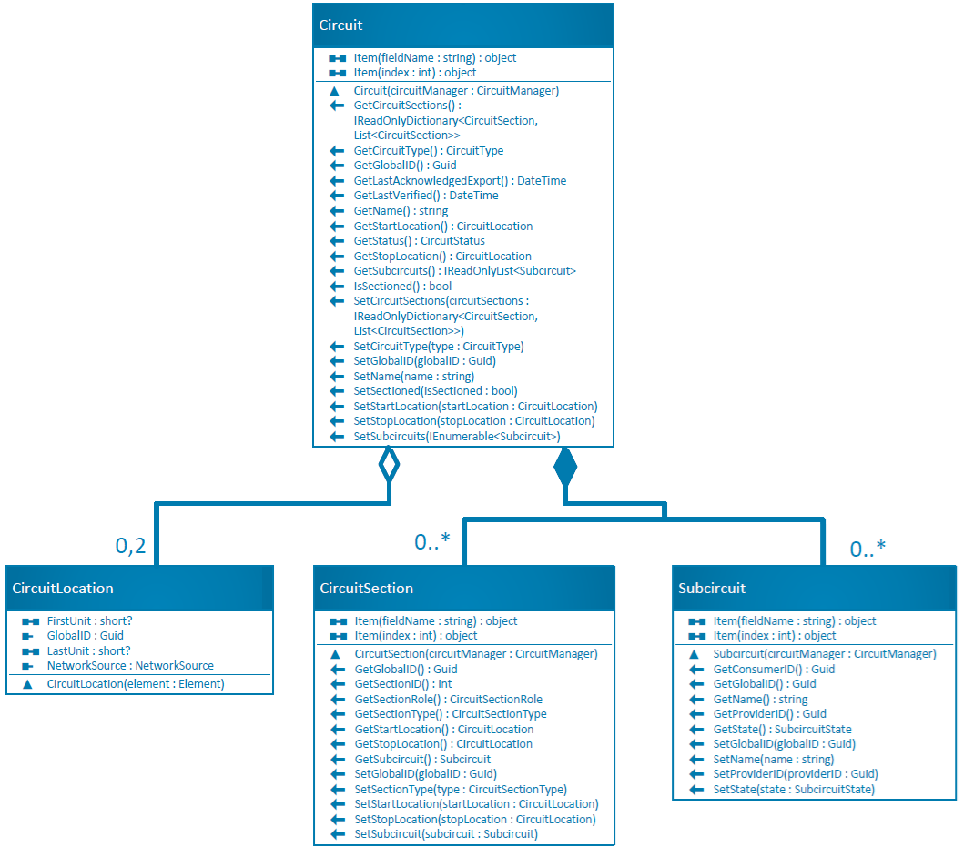

Circuit, CircuitSection, and Subcircuit
Each telecom domain network includes three system-managed tables: Circuit, CircuitSection, and Subcircuit. A circuit represents the set of components that define a signal path between two network elements, and telecom providers may manage hundreds of millions of such circuits to support service delivery.
Circuit
In practice, a circuit is divided into sections, each representing a logical group of connected components identified by a trace operation. Each section has a defined start and stop location; barriers are not supported. Circuits can be physical, with tangible network components, or virtual, providing a dedicated path without physical elements. Users usually know only the endpoints of a virtual circuit, not the specific network details or route.
The Circuit class provides methods for getting and setting circuit properties such as name, type, status, locations, sections, and other relevant information.

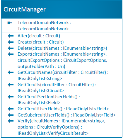

Circuit Manager
The CircuitManager class provides methods for creating, modifying, querying, verifying, and deleting circuits. You can retrieve a CircuitManager object by calling GetCircuitManager() on the UtilityNetwork class. It also provides methods for accessing and updating user-defined attributes for circuits, circuit sections, and subcircuits.
// Get the circuit manager from the utility network
CircuitManager circuitManager = utilityNetwork.GetCircuitManager(telecomDomainNetwork);
The Create method allows users to create a new circuit by using the circuit manager, as shown below.
// Create a new circuit
circuitManager.Create(circuit);
The GetCircuitNames and GetCircuits methods allow users to search for circuits using the flexible CircuitFilter class. This filter enables users to refine results by name, GUID, location, circuit location type, hierarchy, or status.
// Get circuit location from a telecom element
CircuitLocation location = new CircuitLocation(telecomElement);
// Circuit filter by location with specific hierarchy
CircuitFilter circuitFilter = new CircuitFilter([location], CircuitLocationTypeFilter.All) { Hierarchy = CircuitHierarchy.Providers };
// Get circuit names that match the filter
IReadOnlyList<string> circuitNames = circuitManager.GetCircuitNames(circuitFilter);
// Get circuits by names
IReadOnlyList<Circuit> circuits = circuitManager.GetCircuits(circuitNames);
The Alter method allows users to modify existing circuits by providing a modified circuit object. The method compares the modified circuit with the existing circuit and applies the necessary changes.
// Modify an existing circuit
Circuit modifiedCircuit = circuitManager.GetCircuits(new List<string> { circuitName }).FirstOrDefault();
modifiedCircuit.SetName("ModifiedCircuitName");
circuitManager.Alter(modifiedCircuit);
The Delete method allows users to delete one or more existing circuits by name.
// Delete circuits by name
circuitManager.Delete(new List<string> { circuitName });
The Verify method verifies a set of circuits and returns a collection of VerifyCircuitResult objects that contain error information, the circuit name, and synthesized geometry. The CircuitVerifyOptions class defines the options for a circuit verification, such whether to synthesize geometry for virtual sections with provided spatial reference, force verification even when the circuit is marked as clean, and other verification settings.
// Verify circuit
IReadOnlyList<VerifyCircuitResult> verificationResults = circuitManager.Verify(new List<string> {circuitName}, true);
Circuit verification updates the last verified timestamp and checks the circuit's validity so that its status can be updated. If validation succeeds, the circuit is marked as Clean. If validation fails, the method fails and the circuit is marked as Invalid. The following Circuit Status section describes the available circuit statuses and the operations used to transition between them.
Similarly, the Export method allows users to write circuit information, including circuit paths, circuit sections, and subcircuits, to a JSON file. The exported file can be used for data exchange with other systems or for backup purposes, as described in the Trace And Export section.
The CircuitManager class also provides methods for accessing user-defined circuit attributes as described in the next section.

NetworkSource networkSource = utilityNetwork.GetDefinition().GetNetworkSource("TelecomDevice");
// Create a UnitIdentifier for a piece of equipment using its NetworkSource and GlobalID
UnitIdentifier containerUnitIdentifier = new UnitIdentifier(networkSource, containerGlobalID);
UnitIdentifier Manager

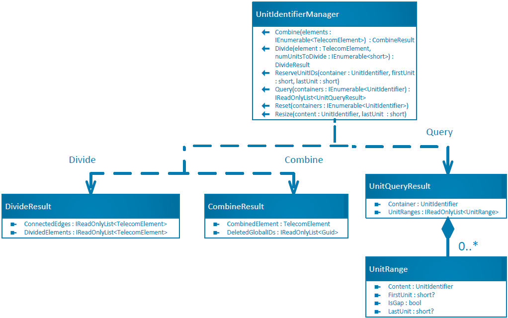

The UnitIdentifierManager provides the following methods for managing unit identifiers:

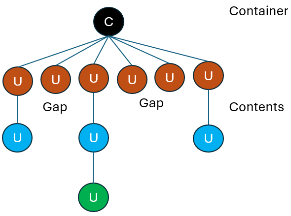

The Query method enables users to retrieve contents from multiple containers as a set of UnitQueryResult objects. Each result includes container details and a collection of content (UnitRange) within the container, including any gaps.
The UnitRange class describes content units within a container, such as ports in a switch or slots in a rack. Together, UnitRange and UnitIdentifier help organize junction objects and establish their logical connections. For example, you can represent a switch with 48 ports as a Container unit, using UnitRange objects for each port. This setup lets users manage connectivity for each port individually.
// Containers to query
UnitIdentifier containerUnitId = new UnitIdentifier(networkSource, globalID);
// Query the unit identifiers in the container
IReadOnlyList<UnitQueryResult> unitQueryResults = unitIdentifierManager.Query(new List<UnitIdentifier> { containerUnitId });
// Iterate through the query results
foreach (UnitQueryResult unitQueryResult in unitQueryResults)
UnitIdentifier unitIdentifier = unitQueryResult.Container;
IReadOnlyList<UnitRange> unitsInAContainer = unitQueryResult.UnitRanges;
// Iterate through the unit ranges (contents) in the container
foreach (UnitRange unitRange in unitsInAContainer)
UnitIdentifier contentUnitId = unitRange.Content;
// True if the content is a gap (empty space reserved for installing a larger piece of equipment)
bool isContentGap = unitRange.IsGap;
short? firstUnit = unitRange.FirstUnit;
short? lastUnit = unitRange.LastUnit;

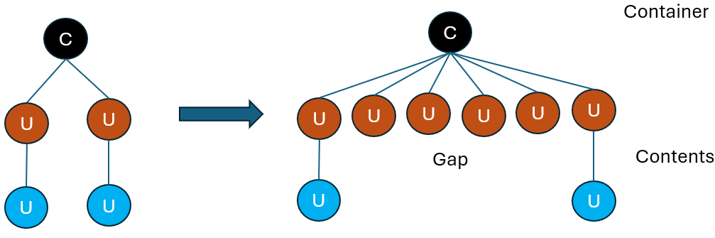

The ReserveUnitIDs method reserves a unit range in container equipment, creating a gap that allows users to prepare for installing a larger unit.
// Reserve a space in the container with unit range, firstUnit:2 to lastUnit:5
unitIdentifierManager.ReserveUnitIDs(containerUnitIdentifier, 2, 5);
This operation shifts existing records in the containment hierarchy of a unit container's NextUnitID sequence to reserve a range of units in a telecom domain network. When a gap is inserted at the end of the sequence, the NEXTUNITID attribute value for the unit container increases. If a gap is inserted into the middle of an existing sequence, the system will attempt to shift existing records to accommodate the reserved space.

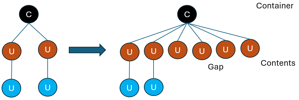

The Resize method changes the number of content units associated with container equipment, and the NEXTUNITID attribute value for the unit container changes accordingly.
// Create a UnitIdentifier for the content
UnitIdentifier content = new UnitIdentifier(networkSource, contentGlobalId);
// Update the number of units (contents) in an equipment container to 6 units
unitIdentifierManager.Resize(content, 6);

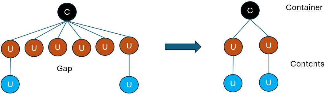

The Reset method removes gaps and condenses the unit space so that it remains contiguous within the equipment hierarchy.
// Reset all containers to remove gaps and make the unit space contiguous
unitIdentifierManager.Reset(new[] { containerUnitIdentifier });
The Divide method divides a telecom element into multiple elements based on a set of units for each divided element. The DivideResult includes the new divided elements and new connected edges created between them.
// For example, a switch with 48 ports can be divided into 4 multiple elements.
DivideResult divideResult = unitIdentifierManager.Divide(telecomElement, new List<short>() { 16, 16, 8, 8 });
The Combine method combines multiple telecom elements into a single element based on their unit identifiers. The CombineResult includes a combined element and GlobalID of the deleted elements.
// Combine the previously divided switch elements back into a single element
CombineResult combineResult = unitIdentifierManager.Combine(new List<TelecomElement>() { telecomElement1, telecomElement2, telecomElement3, telecomElement4 });

Unlike traditional utility networks, telecom domain networks contain mostly non-spatial features and have very high cardinality, with millions of telecom circuits compared to a few thousand electric circuits. In addition, the telecom data model supports complex containment hierarchies, logical grouping of non-spatial objects, and incomplete connectivity that can be resolved by inferring connections through containment. To support this model, the existing trace framework has been expanded to enable tracing through grouped edge and junction objects and to introduce two new trace types: Circuit and Path.
Virtual circuits are often established between start and stop locations where the physical network is unknown. As a result, a Path trace between the start and stop points of a virtual circuit will not succeed, and users should use a Circuit trace in that environment instead.

Unlike other trace types, which use the network index exclusively, circuit trace uses information from both the network index and the circuit tables (Circuit, CircuitSection, and Subcircuit). As a result, circuit trace can trace virtual circuits that are not represented in the network index. It can also use the network index to infer missing connectivity when identifying the path between the starting and stopping locations.
Circuits can be traced either by name or by location, such as a start or stop location. If a circuit is virtual, the geometry for the virtual section is shown as a line between the defining start and stop locations. The following example illustrates how to execute a circuit trace.
Get a circuit to start tracing.
// Get a circuit to start tracing by name Circuit circuitToTrace = circuitManager.GetCircuits(new List<string> { circuitName }).FirstOrDefault();Set trace configuration for the telecom domain network.
// Set trace configuration for the telecom domain network TraceConfiguration traceConfiguration = new TraceConfiguration() { MaxHops = 10, NumPaths = 5, DomainNetwork = telecomDomainNetwork, InferConnectivity = true, SynthesizeGeometries = true };Set the trace argument for the circuit result type (
ResultType.Circuit)// Configure trace argument for circuit trace TraceArgument traceArgument = new TraceArgument(circuitToTrace) { Configuration = traceConfiguration, ResultTypes = new List<ResultType> { ResultType.Circuit }, ResultOptions = new ResultOptions() { IncludeGeometry = true } };Execute the circuit trace.
// Execute the circuit trace CircuitTracer circuitTracer = traceManager.GetTracer<CircuitTracer>(); IReadOnlyList<Result> results = circuitTracer.Trace(traceArgument); // Iterate circuit trace results foreach (Result result in results) { if (result is CircuitResult circuitResult) { IReadOnlyList<CircuitPath> circuitPaths = circuitResult.CircuitPaths; foreach (CircuitPath circuitPath in circuitPaths) { Circuit circuit = circuitPath.Circuit; Path path = circuitPath.Path; IReadOnlyList<PathConnectivity> pathConnectivities = path.PathConnectivities; foreach (PathConnectivity pathConnectivity in pathConnectivities) { Console.WriteLine($"Edge: {pathConnectivity.Edge.GlobalID}, Junction: {pathConnectivity.Junction.GlobalID}"); } Geometry geometry = circuitPath.Geometry; IReadOnlyDictionary<int, Path> sectionPaths = circuitPath.SectionPaths; foreach (KeyValuePair<int, Path> sectionPath in sectionPaths) { int sectionID = sectionPath.Key; Path sectionGeometry = sectionPath.Value; Console.WriteLine($"Section ID: {sectionID}, Section Geometry: {sectionGeometry.Geometry.ToJson()}"); } } } else { Console.WriteLine("Unexpected result type."); } }
Export
To export trace results to a JSON file, use the Export method in the CircuitManager class. Specify the circuit name, destination file path, and CircuitExportOptions, which determine whether to include the domain description, acknowledgments, trace configuration, trace results and options, and synchronization information as illustrated below.
// Circuit names to export
List<string> circuitNames = new List<string> { "LongIslandToLondonCircuit", "VirtualPhillyCircuit", "JacksonVilleToMaineCircuit" };
// Destination JSON file path for the exported circuit information
Uri circuitExportPath = new Uri(@"C:\Path\To\Your\Location");

// Set circuit export options
CircuitExportOptions circuitExportOptions = new CircuitExportOptions()
IncludeDomainDescriptions = true,
ResultOptions = resultOptions,
ResultTypes = new List<ResultType> { ResultType.Circuit, ResultType.Path },
ServiceSynchronizationType = ServiceSynchronizationType.Asynchronous,
SetAcknowledged = false,
TraceConfiguration = traceConfiguration
// Export the circuit information to a JSON file
circuitManager.Export(circuitNames, circuitExportOptions, circuitExportPath);
Refer to the Circuit trace and Path trace section for more details on trace configuration and options.
