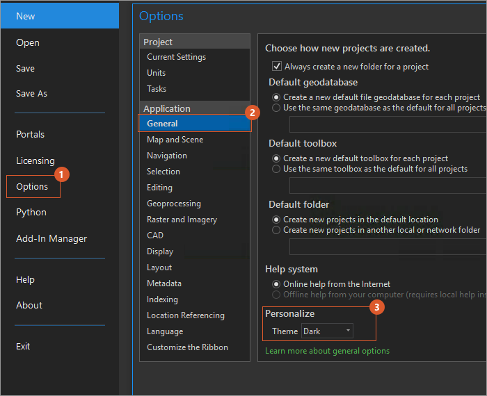

Enabling Themes in Pro
ArcGIS Pro light or dark theme is selected off the pro Backstage, Options, Application settings, General. Scroll down to the Personalize section and select the Light or Dark theme.
ThemeOptions
To toggle themes, the application must be restarted. Note: the selected theme setting is always overridden by the OS level High Contrast mode.
