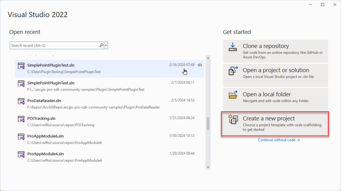

Step 1
Open Visual Studio and select 'Create a New Project'.

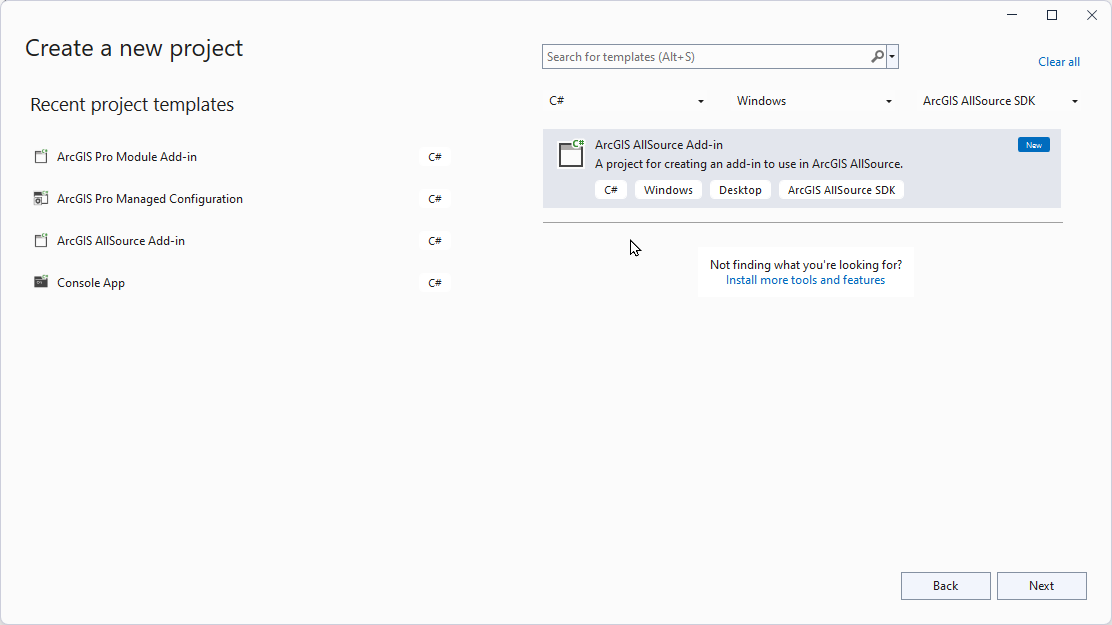

Step 2
On the 'Create a New Project' dialog, use the 'Project Types' dropdown to select 'ArcGIS AllSource SDK'. Make sure that the 'Languages' dropdown is set to 'C#' or to the 'All Languages' default. Select 'ArcGIS AllSource Add-in' as the Project Type and click 'Next'.
Select AllSource Add-in

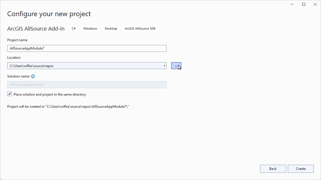

Step 3
The 'Configure you new project/ArcGIS AllSource Add-in' dialog displays allowing you to override the default project name and the default project location. Change the default settings or accept the default. Click 'Create'.
Configure AllSource Add-in

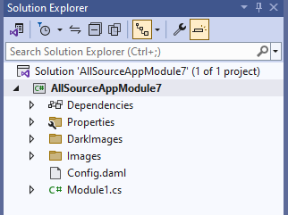

Step 4
Visual Studio creates a new Visual C#. You will notice the following content in your new project:
NewAllSourceContent

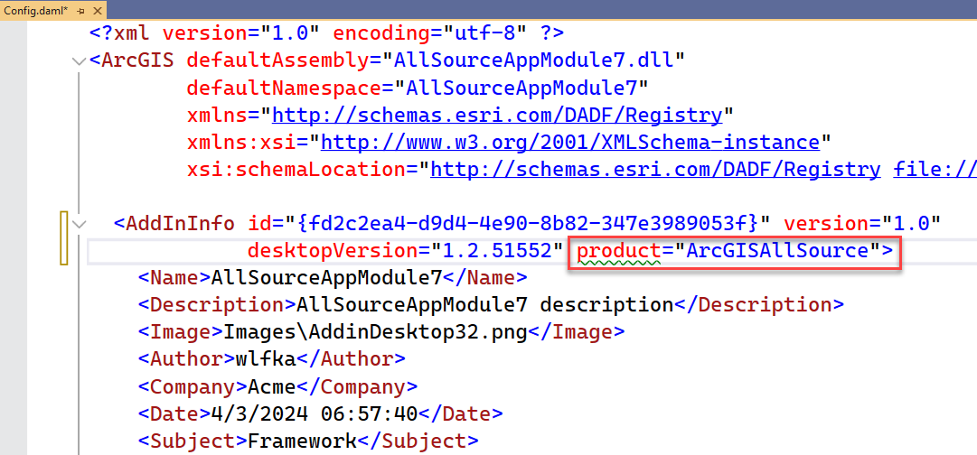

The Config.daml file opens (by default) in Visual Studio. The content of an ArcGIS AllSource config.daml file is similar to the content of an ArcGIS Pro config.daml file. The Config.daml file contains the additional 'product' attribute under the AddInInfo tag:
NewAllSourceConfigDaml

As of release 3.3, a 'product' attribute, with a value of "ArcGISPro", was added to the<AddInInfo /> element in the Config.daml by the SDK addin project template and with a value of "ArcGISAllSource" for AllSource addins (by the AllSource addin project template). This attribute is optional for ArcGIS Pro Add-ins so if it is not present (as will be the case for all addins made prior to 3.3) then a value of "ArcGISPro" is always assumed. An AllSource Add-in, however, must always have a product attribute with a product="ArcGISAllSource" value assigned. As AllSource uses a different versioning scheme to Pro, the desktopVersion attribute must also be changed to reflect the correct version of AllSource being targeted.

Add the product="ArcGISAllSource" attribute to the <AddInInfo ... /> element (or change its value from "ArcGISPro" if there is one there already) and change the desktopVersion attribute to target the desired version of AllSource - v1.2 in this case, i.e. desktopVersion="1.2".
<AddInInfo id="{f..1}" version="1.0"
             desktopVersion="1.2" product="ArcGISAllSource"><!-- note the desktopVersion -->
</AddInInfo>
