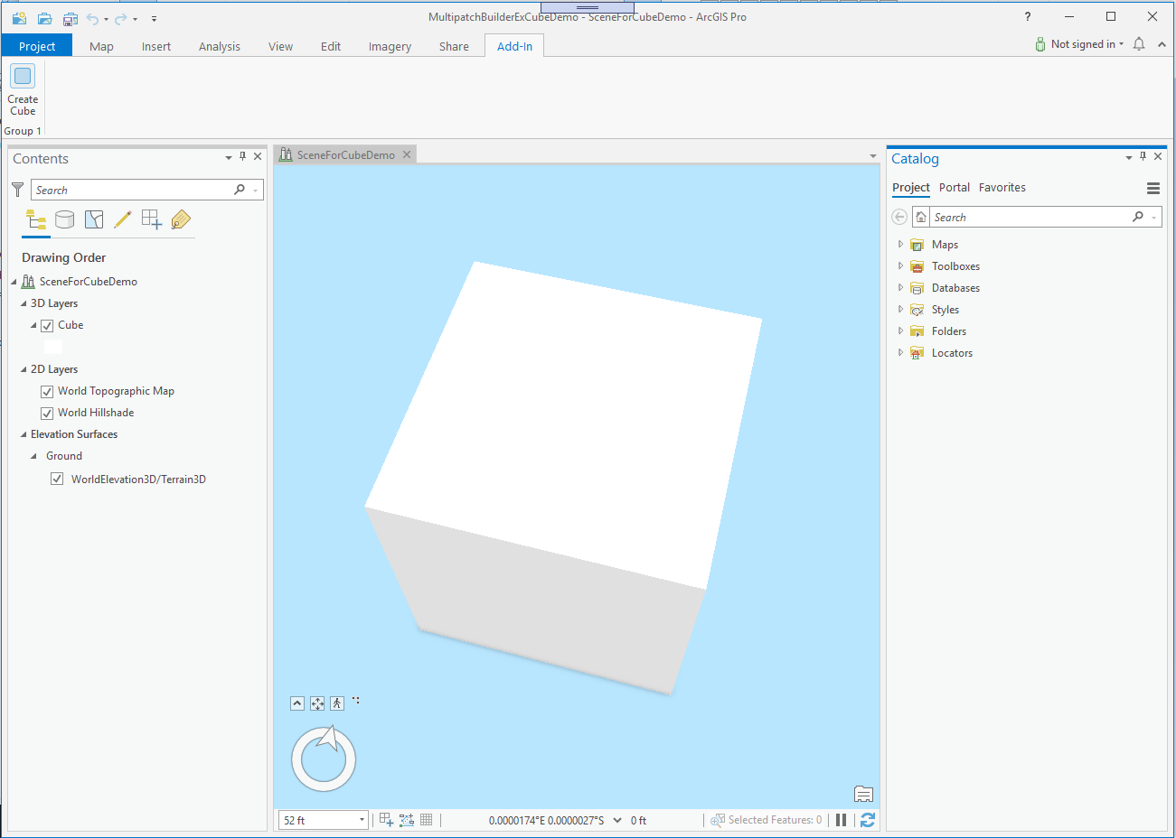

Build the sample and fix any compile errors. Debug the add-in and start ArcGIS Pro. Open the C:\Data\MultipatchBuilderEx\MultipatchBuilderExCubeDemo.aprx project. Validate the UI by activating the Add-In tab.
showPreview
Click the Create Cube button and a new cube multipatch feature will be created.
showPreview

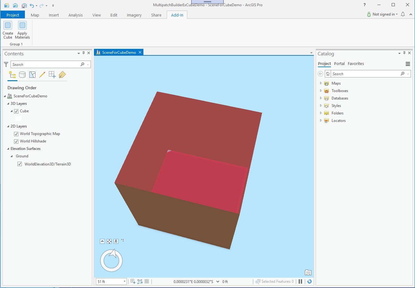

showPreview
Click the Create Cube button to create the multipatch feature. Then click the Apply Materials button to have materials applied to the cube.
showPreview
Stop debugging and return to Visual Studio when you are ready to continue.

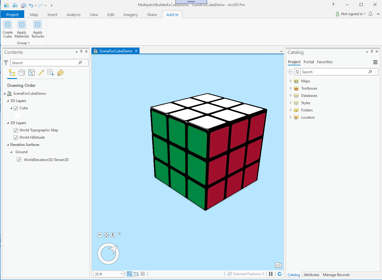

Return to the OnClick method. As with the ApplyMaterials button, we will retrieve a multipatch layer from the map. Using the saved objectID value and the layer, the Inspector class will allow us to retrieve the multipatch feature created in the first step. Use the ApplyTexturesToMultipatch method to apply the textures to the feature's geometry, then the EditOperation class to update the existing multipatch feature with the new multipatch geometry. Any errors are displayed to the user via a MessageBox.
Here is the final OnClick method.
  protected override async void OnClick()
    // make sure there's an OID from a created feature
    if (Module1.CubeMultipatchObjectID == -1)
      return;
    // get the multipatch layer from the map
    var localSceneLayer = MapView.Active.Map.GetLayersAsFlattenedList().OfType<FeatureLayer>()
                          .FirstOrDefault(l => l.Name == "Cube" &&
                                  l.ShapeType == esriGeometryType.esriGeometryMultiPatch);
    if (localSceneLayer == null)
      return;
    // get the multipatch shape using the Inspector
    var insp = new Inspector();
    await insp.LoadAsync(localSceneLayer, Module1.CubeMultipatchObjectID);
    var multipatchFromScene = insp.Shape as Multipatch;
    // apply textures to the multipatch
    var multipatchWithTextures = ApplyTexturesToMultipatch(multipatchFromScene);
    // modify the multipatch geometry
    string msg = await QueuedTask.Run(() =>
      var op = new EditOperation();
      op.Name = "Apply textures to multipatch";
      // queue feature modification
      op.Modify(localSceneLayer, Module1.CubeMultipatchObjectID, multipatchWithTextures);
      // execute
      bool result = op.Execute();
      // if successful
      if (result)
        return "";
      // not successful, return any error message from the EditOperation
      return op.ErrorMessage;
    // if there's an error, show it
    if (!string.IsNullOrEmpty(msg))
      MessageBox.Show($@"Multipatch update failed: " + msg);
showPreview
Click the Create Cube button to create the multipatch feature. Then click the Apply Materials button to have materials applied to the cube. Finally click the Apply Textures button to have the Rubik's cube image be applied.
showPreview
