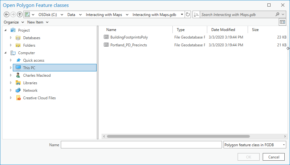

Browse filter to view polygon feature classes in a file geodatabase
This filter will allow you to browse for polygon feature classes in a file geodatabase.
Polygon FGDB
  1. Add a new ArcGIS Pro button item to the add-in project. Name the button class file OpenPolygonFeatureClasses.cs.
  2. Add the following snippet into the OnClick method of the OpenPolygonFeatureClasses.cs.
 //Create an instance of BrowseProjectFilter class
 BrowseProjectFilter bf = new BrowseProjectFilter {
    //Name the filter
    Name = "Polygon feature class in FGDB"
    //Add typeID for Polygon feature class
    bf.AddCanBeTypeId("fgdb_fc_polygon");
    //Allow only File GDBs
    bf.AddDontBrowseIntoFlag(BrowseProjectFilter.FilterFlag.DontBrowseFiles);
    bf.AddDoBrowseIntoTypeId("database_fgdb");
    //Display only folders and GDB in the browse dialog
    bf.Includes.Add("FolderConnection");
    bf.Includes.Add("GDB");
    //Does not display Online places in the browse dialog
    bf.Excludes.Add("esri_browsePlaces_Online");
    //Display the filter in an Open Item dialog
    OpenItemDialog aNewFilter = new OpenItemDialog
        Title = "Open Polygon Feature classes",
        InitialLocation = @"C:\Data",
        MultiSelect = false,
        BrowseFilter = bf
    bool? ok = aNewFilter.ShowDialog();
  1. Build the solution and click start to launch Pro.
  2. Open any project.
  3. Click the Add-in tab and click the OpenPolygonFeatureClasses button.
  4. The OpentItemDialog will be displayed. Browse to a file geodatabase that has polygon feature classes to view them.

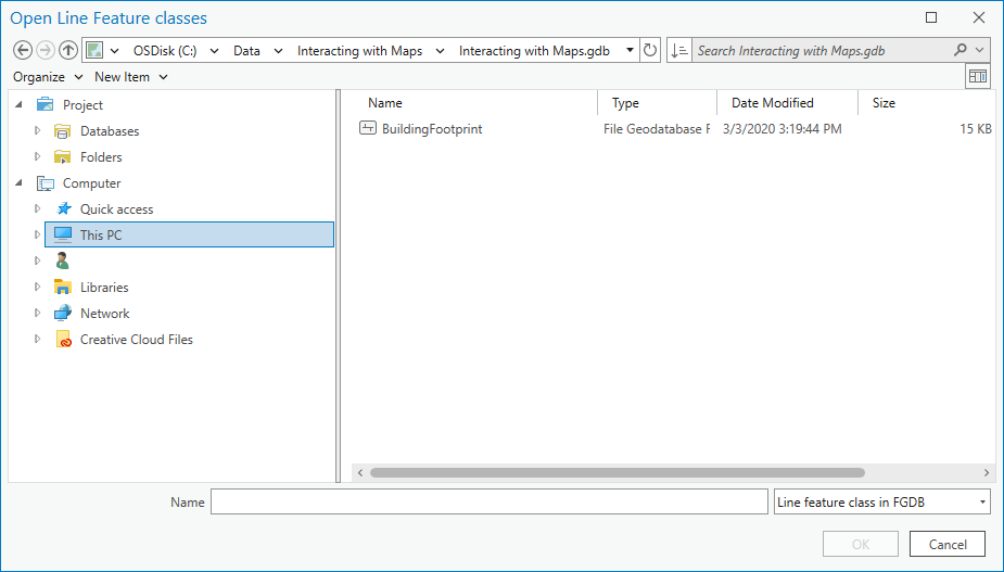

  1. Add a new ArcGIS Pro button item to the add-in project. Name the button class file OpenLineFeatureClasses.cs.
  2. Add the following snippet into the OnClick method of the OpenLineFeatureClasses.cs.
    //Use our filter DAML id - i.e. <insertComponent id="NewLineFeatures_Filter">
    var bf = new BrowseProjectFilter("NewLineFeatures_Filter");
    OpenItemDialog op = new OpenItemDialog
        Title = "Open Line Feature classes",
        BrowseFilter = bf
    bool? ok = op.ShowDialog();
  3. Click the Add-in tab and click the OpenLineFeatureClasses button.
  5. Browse to a folder that has a file geodatabase with line feature classes to view them.

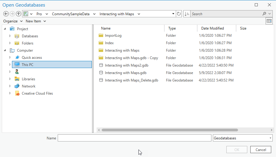

Use Pro's Geodatabase filter
This browse filter uses an existing Pro "esri_browseDialogFilters_geodatabases" filter. Geodatabase
  1. Add a new ArcGIS Pro button item to the add-in project. Name the button class file OpenGeodatabases.cs.
  2. Add the following snippet into the OnClick method of the OpenGeodatabases.cs.
    //Create instance of BrowseProjectFilter using the id for Pro's file geodatabase filter
  BrowseProjectFilter bf = new BrowseProjectFilter("esri_browseDialogFilters_geodatabases");
        Title = "Open Geodatabases",
        //Set the BrowseFilter property to Pro's Geodatabase filter.
        BrowseFilter = bf
  3. Click the Add-in tab and click the OpenGeodatabases button.
  5. Browse to a folder that has geodatabases to view them.

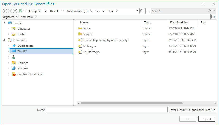

Modify Pro's LYRX file filter to include LYR files
This browse filter modifies Pro's "esri_browseDialogFilters_layers_lyrx" browse filter to display lyr files also.
Lyr and Lyrx
  1. Add a new ArcGIS Pro button item to the add-in project. Name the button class file OpenLayerAndLayerXFiles.cs.
  2. Add the following snippet into the OnClick method of the OpenLayerAndLayerXFiles.cs.
    //Create BrowseProjectFilter class instance
    //Pass in id of Pro's Lyrx filter
    BrowseProjectFilter lyrXLyrGeneral = new BrowseProjectFilter(
      "esri_browseDialogFilters_layers_lyrx");
    lyrXLyrGeneral.Name = "Layer Files (LYRX) and Layer Files (LYR)";
    //Additionally, add the type id for lyr files to this BrowseProjectFilter class
    lyrXLyrGeneral.AddCanBeTypeId("layer_general");
    lyrXLyrGeneral.AddDontBrowseIntoFlag(BrowseProjectFilter.FilterFlag.DontBrowseFiles);
    lyrXLyrGeneral.Includes.Add("FolderConnection");
    lyrXLyrGeneral.Includes.Add("GDB");
    //Do not display Online places in the browse dialog
    lyrXLyrGeneral.Excludes.Add("esri_browsePlaces_Online");
        Title = "Open LyrX and Lyr General files",
        BrowseFilter = lyrXLyrGeneral
  3. Click the Add-in tab and click the OpenLayerAndLayerXFiles button.
  5. Browse to a folder that has any ".lyr" and ".lyrx" files to view them.

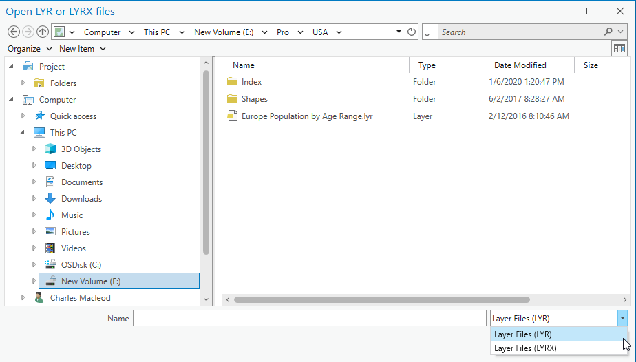

Composite filter
In an OpenItemDialog, you can add multiple filters to the filter dropdown list. This creates a browse experience that allows you to pick the type of file you want to browse for in that dialog. This composite filter example will allow you to view "lyr" or "lyrx" files.
Composite Filter
  1. Add a new ArcGIS Pro button item to the add-in project. Name the button class file OpenLayerOrLayerXFiles.cs.
  2. Add the following snippet into the OnClick method of the OpenLayerOrLayerXFiles.cs.
    BrowseProjectFilter compositeFilter = new BrowseProjectFilter();
    //Add an existing Pro Lyr filter to the BrowseProjectFilter instance
    compositeFilter.AddFilter(BrowseProjectFilter.GetFilter(
                                 "esri_browseDialogFilters_layers_lyr"));
    //Add an existing Pro Lyrx filter to the BrowseProjectFilter instance
                                 "esri_browseDialogFilters_layers_lyrx"));
    //Customize the "Browse Places"
    compositeFilter.Includes.Add("FolderConnection");
    compositeFilter.Excludes.Add("esri_browsePlaces_Online");
        Title = "Open LYR or LYRX files",
        BrowseFilter = compositeFilter
  3. Click the Add-in tab and click the OpenLayerOrLayerXFiles button.
  4. The OpenItemDialog will be displayed. Notice the file filter drop down at the bottom right. You will notice two choices to filter files with - Layer Files (LYRX) and Layer Files (LYR).

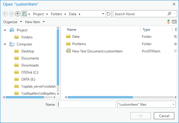

Browse filter to view a custom item
This filter will allow you to view a custom item.
Note: Custom items are a special type of item that allows 3rd parties to add (or "include") their proprietary file types into Pro and to define the custom behavior, context menu items, etc. for "that" particular content type. In this example, "customItem" is a type that registered with Pro. ProConcepts: Custom Items
Custom Item
  1. Add a new ArcGIS Pro button item to the add-in project. Name the button class file OpenCustomItem.cs.
  2. Add the following snippet into the OnClick method of the OpenCustomItem.cs.
    BrowseProjectFilter bf = new BrowseProjectFilter();
    //Name the filter
    bf.Name = "\"customItem\" files";
    //Add typeID for Filters_ProGPXItem custom item.
     //Custom items
    bf.AddCanBeTypeId("Filters_ProGPXItem");
    //Does not allow browising into files
        Title = "Open \"customItem\"",
        BrowseFilter = bf
  3. Build the solution and click start to launch Pro.
  4. Open any project.
  5. Click the Add-in tab and click the OpenCustomItem button.
  6. The OpentItemDialog will be displayed. If you have the community samples installed, browse to C:\Data\BrowseDialogFiltersBrowse to view a file with the "customItem" file extension.

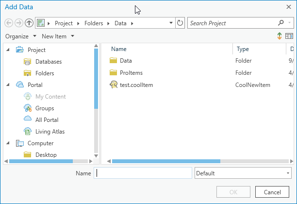

Display custom item in "add to map" dialog
This demonstrates how to view a custom item in Pro's "Add To Map" dialog.
  1. Add an "ArcGIS Pro Custom Item" to the addin project using the ArcGIS Pro SDK templates. Name the class file ProGPXItem.cs.
  2. The template adds the following snippet that registers the CustomBrowseDialogFilters_ProGPXItem item with the esri_customItems category. Locate this code snippet in your add-in's config.daml. Note: In this example below, the add-in project name is "CustomBrowseDialogFilters". The Custom item component id stubbed out by Visual Studio is "CustomBrowseDialogFilters_ProGPXItem".
    <categories>
        <updateCategory refID="esri_customItems">
          <insertComponent id="CustomBrowseDialogFilters_ProGPXItem"
                  className="CustomBrowseDialogFilters_ProGPXItem">
            <content displayName="CustomBrowseDialogFilters_ProGPXItem"
                fileExtension="acmeXXXX" isContainer="false"
                keywords="CustomBrowseDialogFilters_ProGPXItem"
                contextMenuID="CustomBrowseDialogFilters_ProGPXItem_ContextMenu">
              <filterFlags>
                <!--Change this flag as needed. See FilterFlag enum. Example:
                    AddToMap, DontBrowseFiles...-->
                <type id="File" />
              </filterFlags>
            </content>
          </insertComponent>
        </updateCategory>
    </categories>
  3. Modify the "fileExtension" attribute of the content element to be "customItem".
  4. Modify the id attribute of the content > filterFlags > type element to be "AddToMap". It is set to "File" by default. The completed code snippet is given below:

  5. Build the solution and click start to launch Pro.
  6. Open any project with a MapView.
  7. With the MapView active, click the Add to map button on the Pro ribbon.
  8. If you have the community samples installed, browse to C:\Data\BrowseDialogFiltersBrowse to view a file with the "customItem" file extension.
