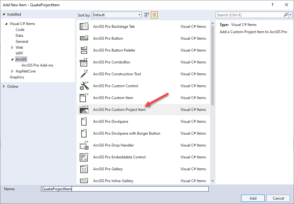

  • Create a new ArcGIS Pro Module Add-in, and name the project QuakeItem. If you are not familiar with the ArcGIS Pro SDK, you can follow the steps in the ProGuide Build your first add-in to get started.
  • Once the Solution is open in Visual Studio right click on the project, select Add New Item, drill down to the ArcGIS Pro Add-ins, select ArcGIS Pro Custom Project Item, and name the item QuakeProjectItem.

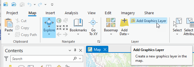

Build the sample and start debugging. Open the ArcGIS Pro. Create a new map with a 2D Map. In the catalog window, under the "Folders" project container, add a new Folder connection to where-ever is the location of the "QuakeCustomItem" data downloaded from the community samples data. In this guide, the data was copied to a folder called "QuakeCustomItemData" but your location may be different. Expand or double-click on the QuakeCustomItemData folder. The earthquakes.quake file should be displayed using the Bex the dog icon:

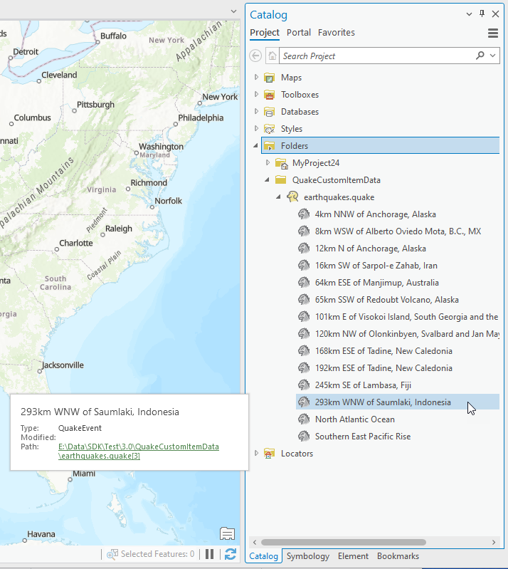

Add Child records (Quake Events) to a Custom Project Item
earthquakes.quake is an XML document containing child <event .../> elements representing QuakeEvents. We will add these QuakeEvents as child items to QuakeProjectItem.
Open the source for QuakeProjectItem. To indicate that QuakeProjectItem has children change IsContainer to true.
public override bool IsContainer => true;

Verify that Custom Project Item with child records works

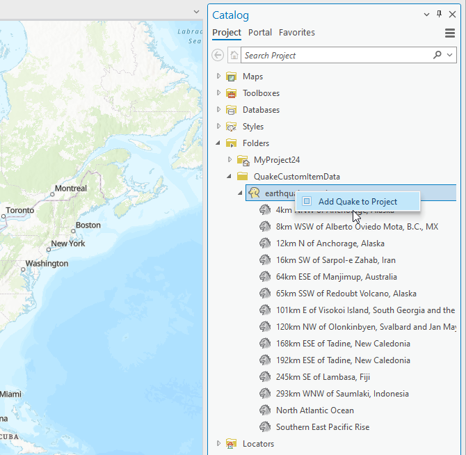

Rebuild the add-in. Fix any compilation errors. Run the Add-in in debug mode. Open your project. After it has been loaded, open the ArcGIS Pro Catalog Dockpane, and drill down to Folders | QuakeCustomItemData | earthquakes.quake. earthquakes.quake should display the Bex the dog icon. Now, when you expand earthquakes.quake, you should now see all the quake event children rendered with the T-Rex icon.
Step 4
Add Custom Project Item to project
In this step we verify that we can add the earthquakes.quake Custom Project Item as a Project Item to the project. The QuakeItems_QuakeProjectItem_ContextMenu context menu which is referenced and defined in config.daml allows you to trigger the AddToProject OnClick method. The AddToProjectQuakeProjectItem code behind is used to add the Custom Project Item to a QuakeProjectItemContainer. The code for this has already been stubbed out by the Custom Project Item Item Template we used early.
internal class AddToProjectQuakeProjectItem : Button
  protected override void OnClick()
    var catalog = Project.GetCatalogPane();
    var items = catalog.SelectedItems;
    var item = items.OfType<QuakeProjectItem>().FirstOrDefault();
    if (item == null)
    	return;
    QueuedTask.Run(() => Project.Current.AddItem(item));
As can be seen in the code snippet above the current selected QuakeProjectItem is simply added the Project Items of the current project.

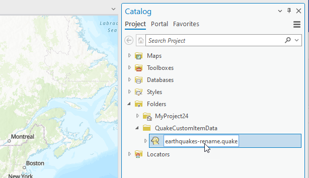

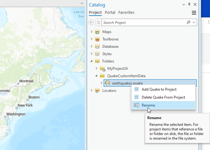

To rename a Custom Project Item from within the ArcGIS Pro Catalog pane we can simply use the existing out-of-box renaming button esri_core_rename of ArcGIS Pro and add the esri_core_rename button to the Custom Project Item's context menu. This is solely done in DAML, the snippet below shows the addition of the rename button to the MyCustomItem Context Menu:
<menu id="ProItemEarthQuake_QuakeProjectItem_ContextMenu" caption="QuakeProjectItem_Menu">
  <button refID="ProItemEarthQuake_QuakeProjectItem_AddToProject" />
  <button refID="esri_core_rename" />
</menu>
Build the sample and start debugging. Open your Pro project and the QuakeCustomItemData folder. Right-click and rename earthquakes.quake by using the "Rename" Context Menu button or by simply double-clicking on the Custom Project Item name to enable editing of the name.

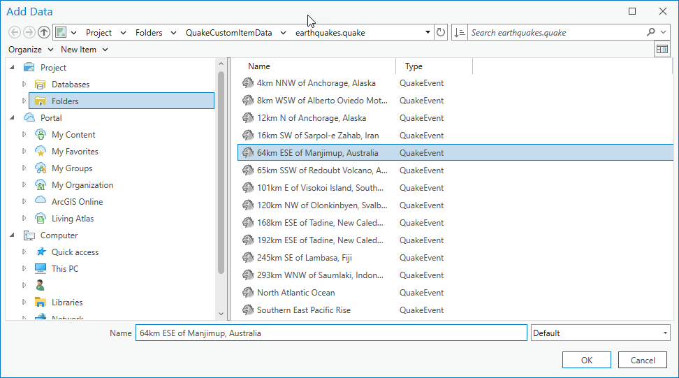

Add support for browsing for custom project items

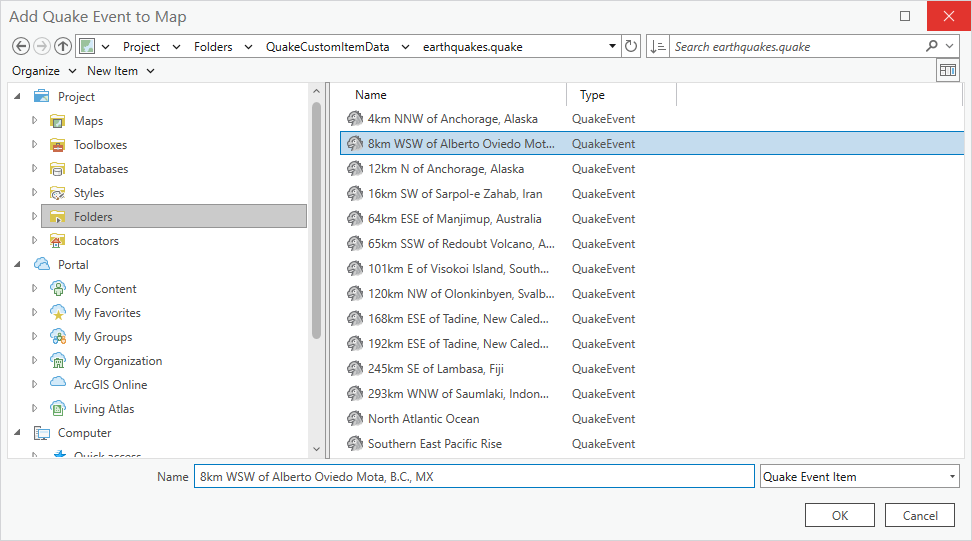

In this step we will be creating a BrowseProjectFilter to configure the OpenItemDialog to browse to ".quake" custom project items, expand it, and list the child quake event custom items. Refer to Browse dialog filters for more information on creating and configuring item filters. Whenever an event is picked, its location will be added to the active map (as long as its a 2D map).
In the Visual Studio solution explorer, right click on the project node and add an ArcGIS Pro Button item. In the add item dialog, name this button class file as QuakeEventItemDialog. QuakeEventItemDialog.cs file will be created. This button will display Pro's OpenItemDialog and allow you to filter for the ".quake" files. Change the button caption in the Config.daml to "Add Event to Map". Add the following condition to the button definition: esri_mapping_graphicsLayersExistCondition.
The daml for the QuakeEventItemDialog button should look like this: (your button id and classname may be different):
<button id="..." caption="Add Quake Event to Map" ...
   condition="esri_mapping_graphicsLayersExistCondition">
       <tooltip heading="Tooltip Heading">Tooltip text<disabledText /></tooltip>
</button>
In the OnClick method that is stubbed out, add the following code. We first create the BrowseProjectFilter instance and then set the filter properties for this class using the AddCanBeTypeId method. acme_quake_handler is passed to the AddCanBeTypeId method as the typeID for the "quake" item. Since the quake item is a "container" that holds the individual quake events, we can modify the filter behavior to allow browse into the custom quake project item and display the quake events in the container so we can select them.
First, we use the AddDoBrowseIntoTypeID method on the BrowseProjectFilter instance and pass in the acme_quake_handler typeID of the quake item. This enables browsing into the .quake event. Additionally, to allow us to view the individual events within the "quake" container, we add the acme_quake_event TypeID (for the quake events) using AddCanBeTypeId. We then create the OpenItemDialog and set the BrowseFilter property to the BrowseProjectFilter instance created. The entire OnClick method is shown below:
protected override void OnClick() {
  var bf = new BrowseProjectFilter();
  //This allows us to view the .quake custom item (the "container")
  bf.AddCanBeTypeId("acme_quake_handler"); //TypeID for the ".quake" custom project item
  bf.AddDoBrowseIntoTypeId("acme_quake_handler");
  //This allows us to view the quake events contained in the .quake item
  bf.AddCanBeTypeId("acme_quake_event"); //TypeID for the quake events contained in the .quake item
  bf.Name = "Quake Item";
  var openItemDialog = new OpenItemDialog {
     Title = "Add Quake Event to Map",
     InitialLocation = @"C:\Data\QuakeCustomItemData,//or whatever is the location of your data
     BrowseFilter = bf,
     MultiSelect = false
  bool? ok = openItemDialog.ShowDialog();
  if (ok != null) {
    if (ok.Value) {
      var quake_event = openItemDialog.Items.First() as QuakeEventCustomItem;
      QueuedTask.Run(() => {
        Module1.AddToGraphicsLayer(quake_event);

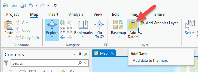

Step 7
In this step we add the capability to browse to .quake files and .quake events using the built-in 'Add Data' button on the Map tab.
In order to implement browsing / adding data to the map via the "Add Data" the QuakeEventProjectItem class which inherits CustomProjectItemBase has to implement IMappableItem. The AddData dialog uses IMappableItem to determine if an item that has been browsed to can be added to the map. This will allow our items to be selected and added (via the built-in dialog):
Change the following class definition:
internal class QuakeEventProjectItem : CustomProjectItemBase
...and add an IMappableItem implementation:
internal class QuakeEventProjectItem : CustomProjectItemBase, IMappableItem
 //Map must be 2D with a Graphics Layer added
 public bool CanAddToMap(MapType? mapType) {
    if (mapType != null) {
      if (mapType != MapType.Map)
        return false;
    return MapView.Active?.Map.GetLayersAsFlattenedList()
        .OfType<GraphicsLayer>().FirstOrDefault() != null;
  public List<string> OnAddToMap(Map map) {
    return OnAddToMap(map, null, -1);
  public List<string> OnAddToMap(Map map, ILayerContainerEdit groupLayer, int index) {
    var uri = Module1.AddToGraphicsLayer(this);
    return new List<string> { uri };
Finally an update to the config.daml is also required, you had to add the following filterFlags tag to each content tag, as shown here:
<insertComponent id=....>
<content displayName="QuakeProjectItem" ...>
  <filterFlags>
    <type id="AddToMap" />
  </filterFlags>
</content>
<content displayName="QuakeEventItem" ...>
  <filterFlags>
  </filterFlags>
</content>
Rebuild the add-in solution. Run the add-in in debug mode. Open your project sample. Open the AddData dialog from the Map tab. Browse to your .quake event data and add an event to the map.
