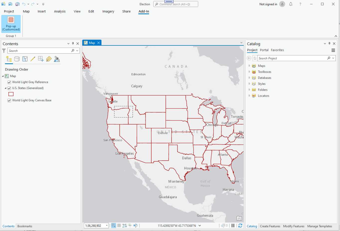

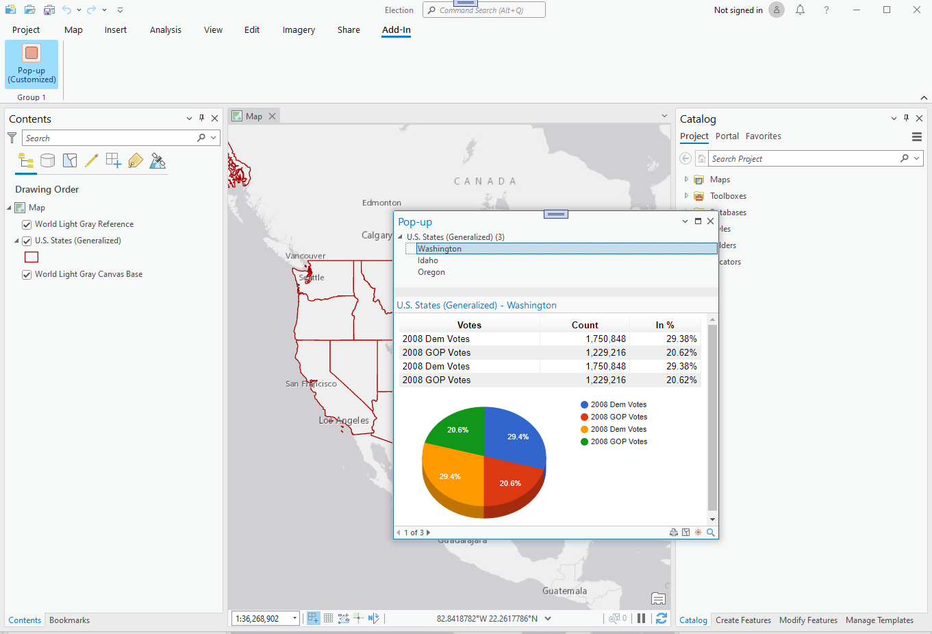

Step 5
Rebuild the add-in. Fix any compilation errors.
Step 6
Debug the add-in. Run the debugger and start ArcGIS Pro. Open the C:\Data\ElectionData\Election.aprx project that contains a dataset that works the custom pop-up. Try the custom pop-up tool, and select some states as shown here:
