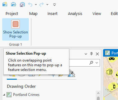

Modify the Config.daml file tool item as follows:
  • Change the caption to "Show Selection Pop-up".
  • Change the tool heading to "Show Selection Pop-up" and the ToolTip text to "Click on overlapping point features on this map to pop-up a feature selection menu."
<tool id="MapToolWithDynamicMenu_MapToolShowMenu" caption="Show Selection Pop-up"
              className="MapToolShowMenu" loadOnClick="true"
              smallImage="GenericButtonRed16" largeImage="GenericButtonRed32"
              condition="esri_mapping_mapPane" keytip="z2">
  <tooltip heading="Show Selection Pop-up">
    <disabledText />
  </tooltip>
</tool>
Build the sample and validate the UI on the ArcGIS Pro ribbon.

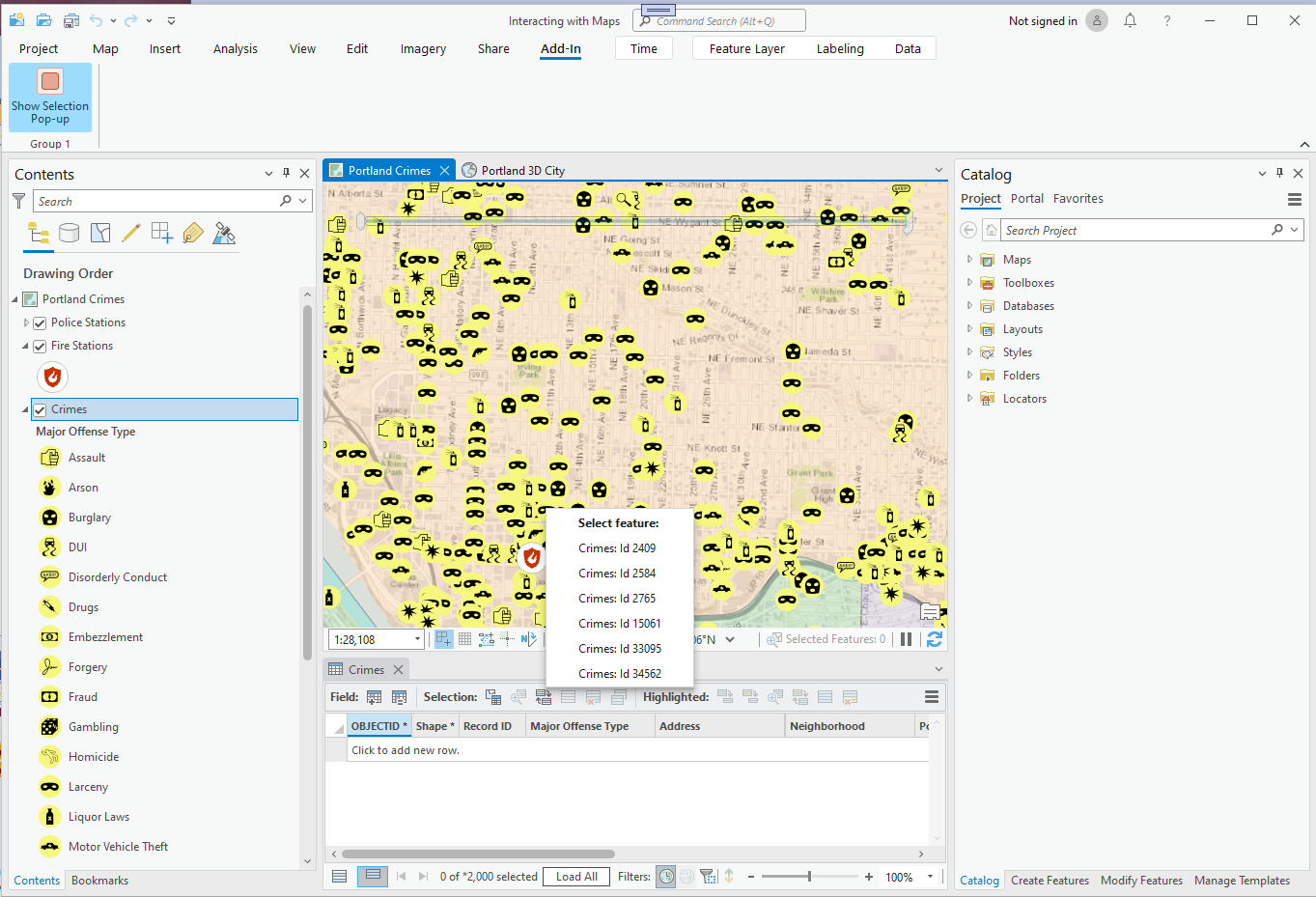

Debug the add-in. Run the debugger and start ArcGIS Pro. Open the C:\Data\Interacting with Maps\Interacting with Maps.aprx project that contains a dataset that works with this sample. Try the selection tool over a map area with a high point feature density as shown here:

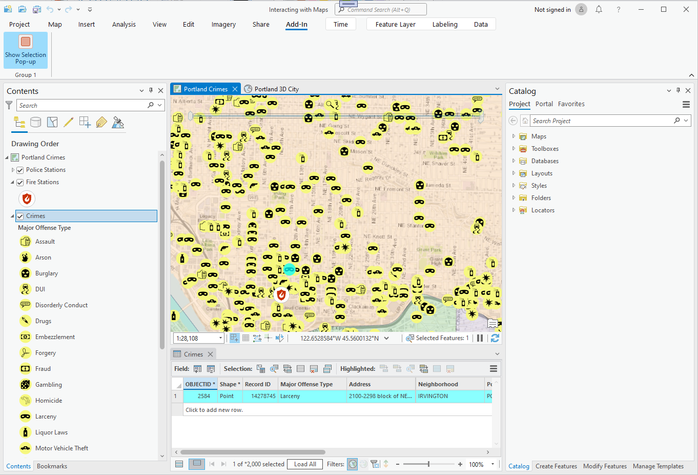

Choose an item from the popup menu add see the feature be selected in the map.
