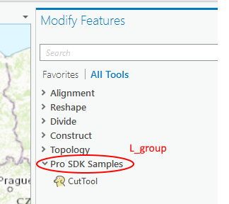

Open the Config.daml file and go to the entry for the tool. Add a categoryRefID attribute setting it to categoryRefID="esri_editing_CommandList". This specifies the tool is to appear in the Modify Features pane. Also add a content xml node to the tool specification. The attribute L_group specifies the group that the tool will live under in the Modify Features pane. Use your own group name to create a new group entry in the pane. The tool daml should be as below
<tool id="ProAppModule1_CutTool" categoryRefID="esri_editing_CommandList"
      caption="CutTool" className="CutTool" loadOnClick="true"
      smallImage="Images\GenericButtonRed16.png"
      largeImage="Images\GenericButtonRed32.png">
  <tooltip heading="Tooltip Heading">Tooltip text<disabledText /></tooltip>
  <content L_group="Pro SDK Samples" />
</tool>
ProGuide: Editing - SketchTool L_group

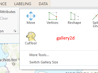

The attributes gallery2d and gallery3d also live within the content tag and specify whether the tool is shown in the favorites group in the gallery for 2D or 3D editing tools on the Edit ribbon. In this guide, you'll add the tool to the favorites group in the 2D gallery so set the gallery2d to true and the gallery3d to false.
ProGuide: Editing - SketchTool gallery2d
The modified xml configuration for the editing tool should look similar to the following definition:
