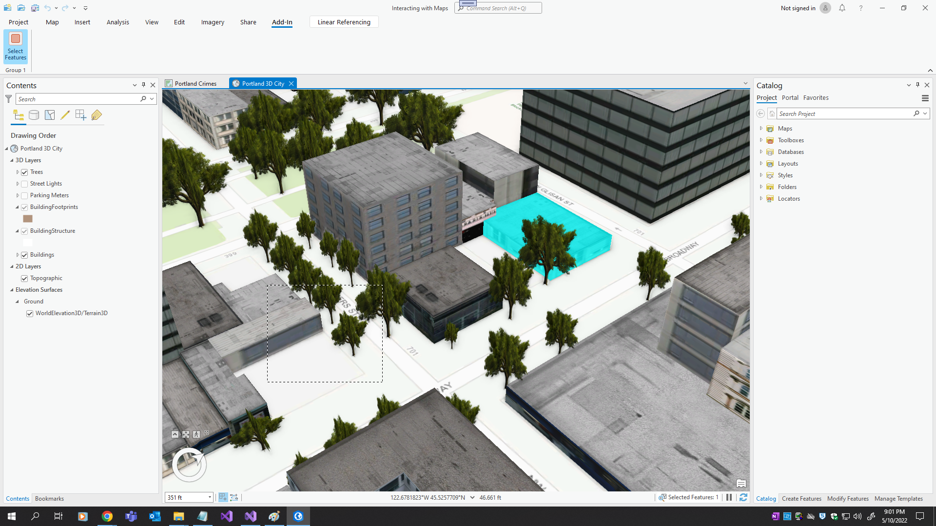

Debug the add-in. Run the debugger and start ArcGIS Pro. Open the C:\Data\Interacting with Maps\Interacting with Maps.aprx project that contains a 3D map with feature data. Try the selection tool on the 3D scene as shown here:
