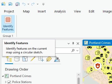

Modify the Config.daml file tool item as follows:
  • Change the caption to "Identify Features."
  • Change the tool heading to "Identify Features" and the ToolTip text to "Identify features on the current map using a circular sketch."

Build the sample and validate the UI on the ArcGIS Pro ribbon:

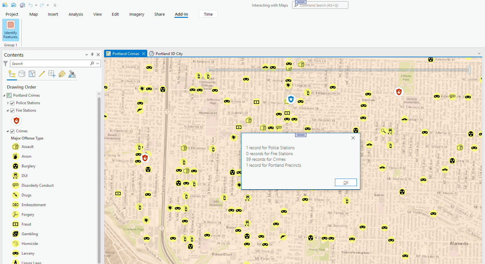

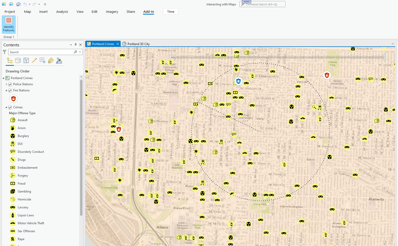

Debug the add-in. Run the debugger and start ArcGIS Pro. Open the C:\Data\Interacting with Maps\Interacting with Maps.aprx project that contains 2D and 3D maps with feature data. Try the Identify tool on the 2D map as shown here:
Verify the Identify result.

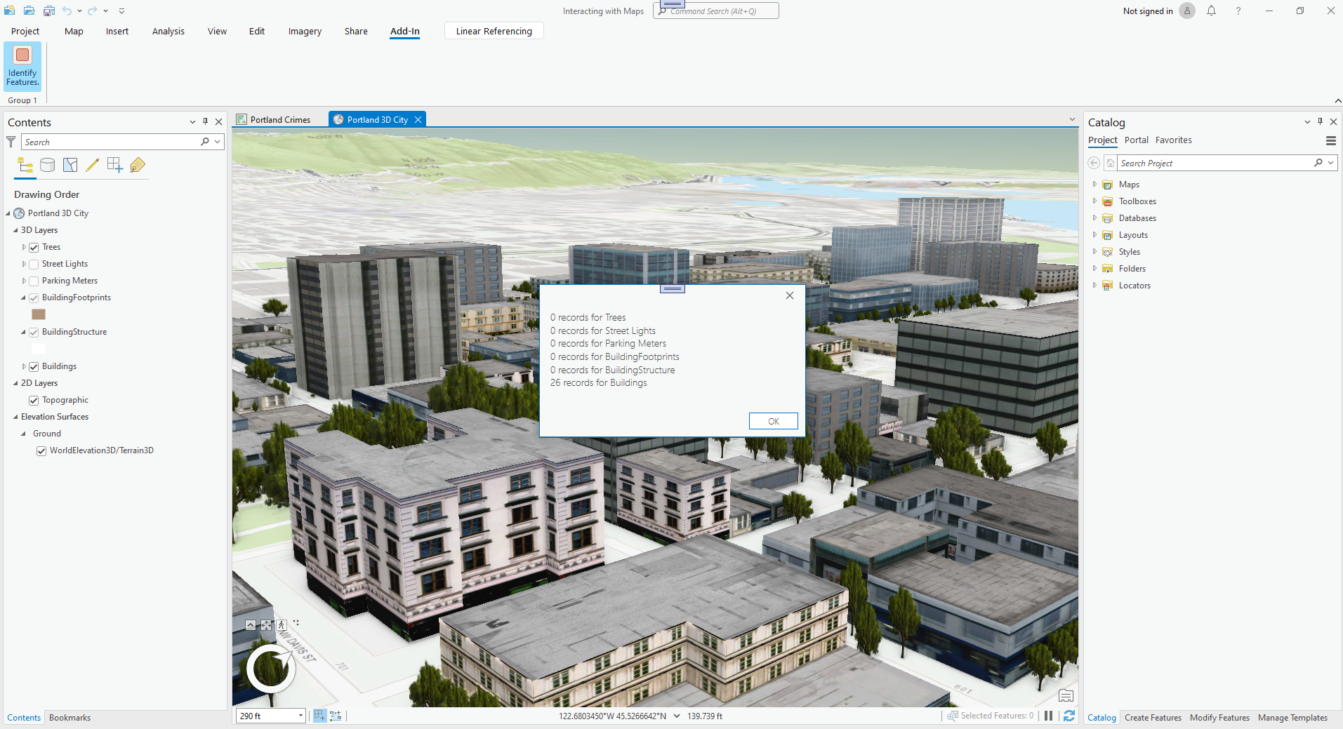

Try the Identify tool on the 3D scene as shown here:
