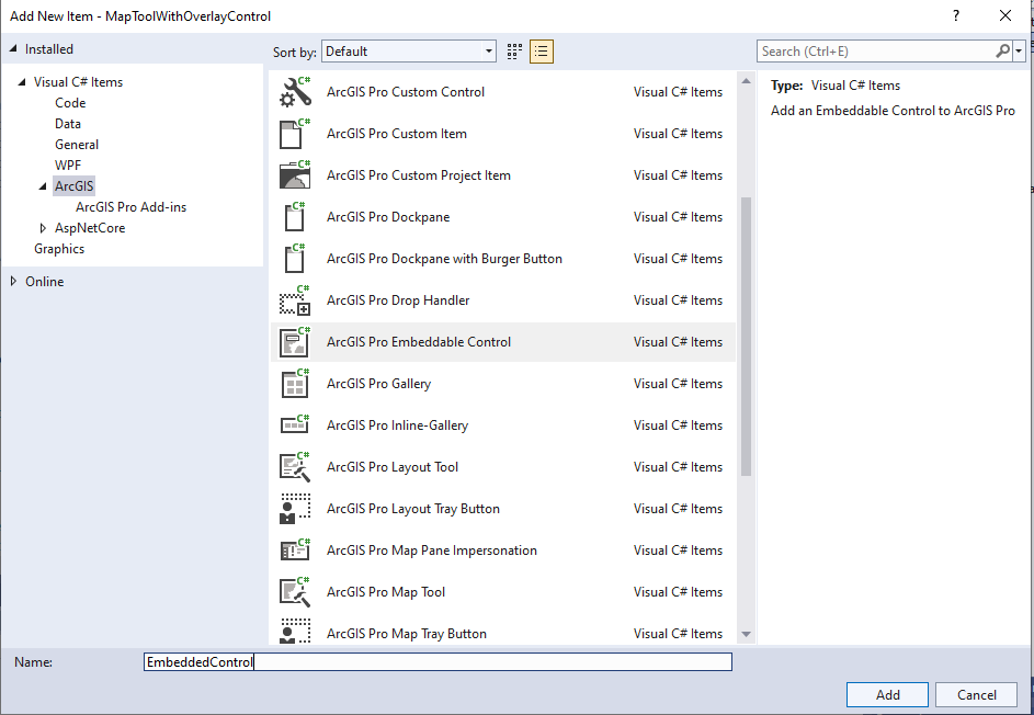

  • Add a new ArcGIS Pro Add-ins | ArcGIS Pro Embeddable Control item to the add-in project, and name the item EmbeddedControl.

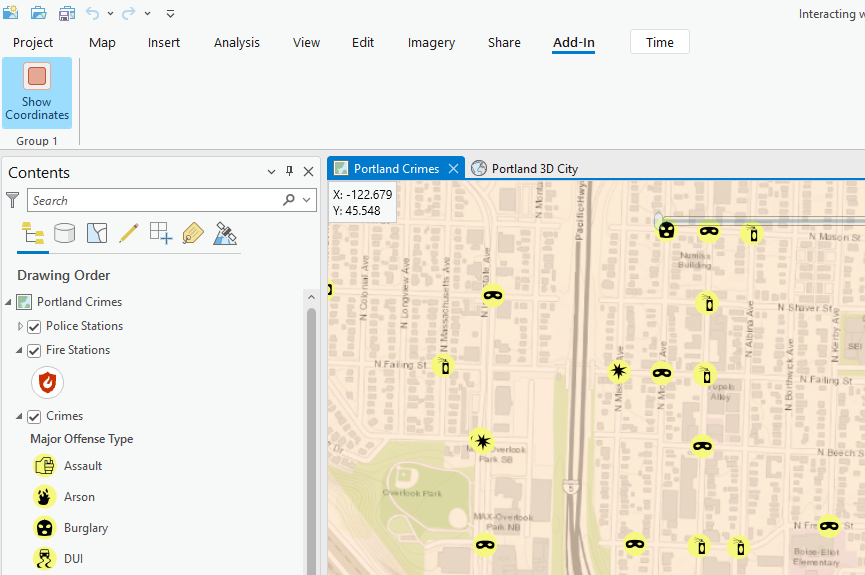

Debug the add-in. Run the debugger and start ArcGIS Pro. Open the C:\Data\Interacting with Maps\Interacting with Maps.aprx project that contains 2D and 3D maps with feature data. Try the tool on the 2D map as shown here:

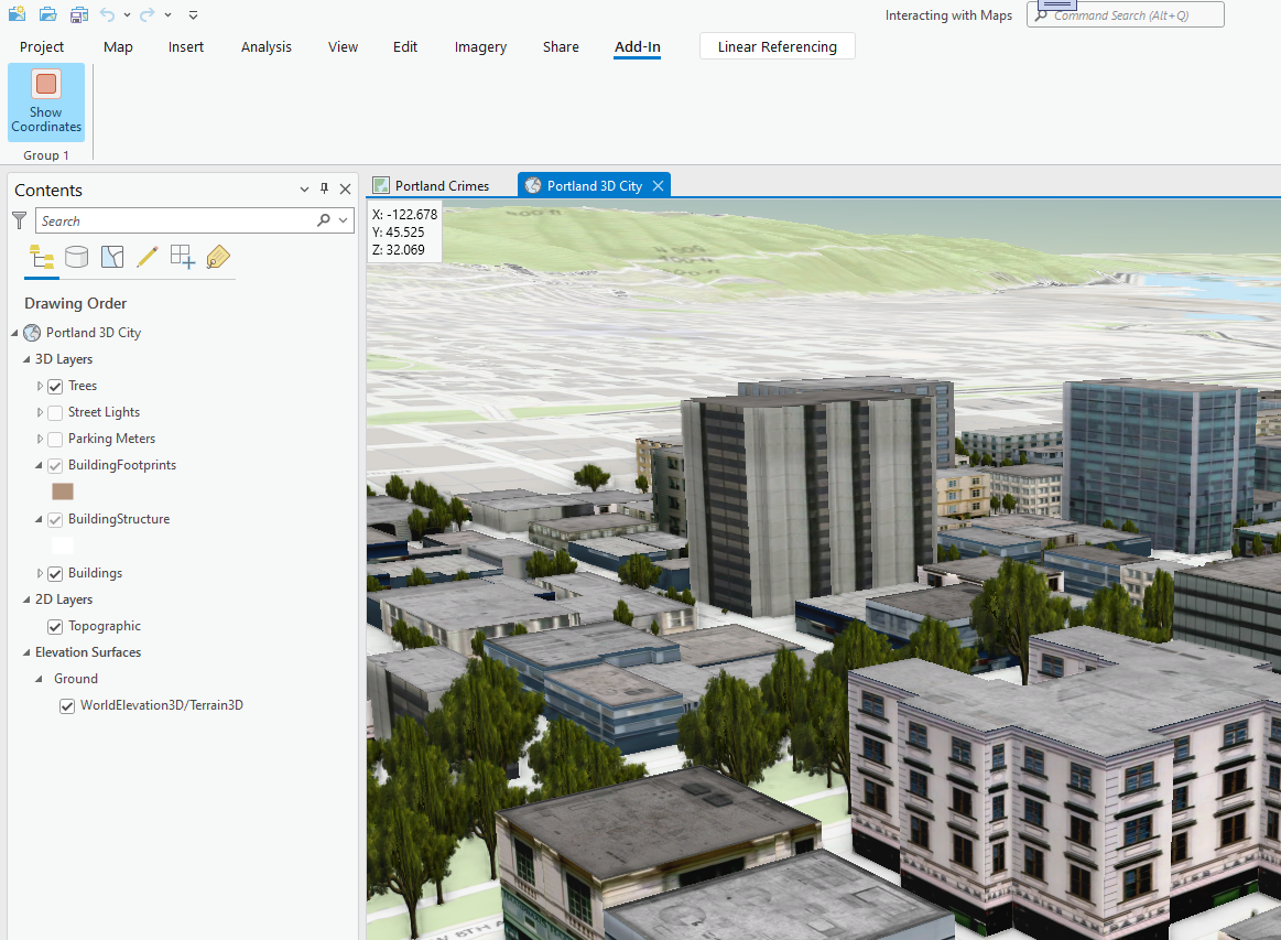

Try the tool on the 3D scene as shown here:
